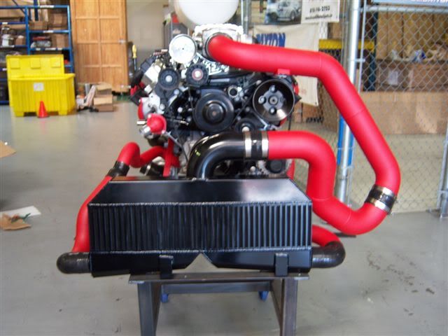

Just got back from PRI - I am sure you know it is sometimes hard to reach George so if we can help just let us know - Plus George no longer supports the forum so we don't want to get in trouble with Tran. GMS is still in go standing
Joe Granatelli
www.granatellimotorsports.com
805-486-6644
Here is a video from PRI - but we could not take the display engine with us

Old 12-15-2010, 07:40 PM   #40
Z_Rocks
Z_Rocks's Avatar
Drives: everyone crazy...
Location: SW Florida
Posts: 2,109
Joe Granatelli
805-486-6644
Very nice and informative video. Lots of enthusiasm there...
