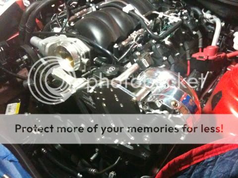

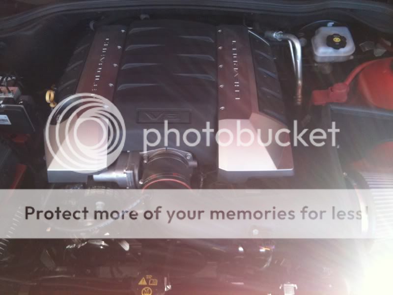

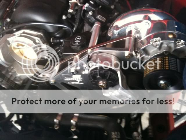

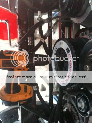

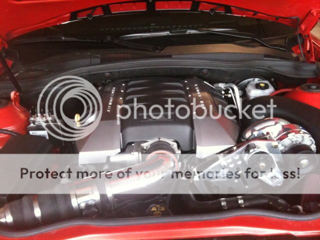

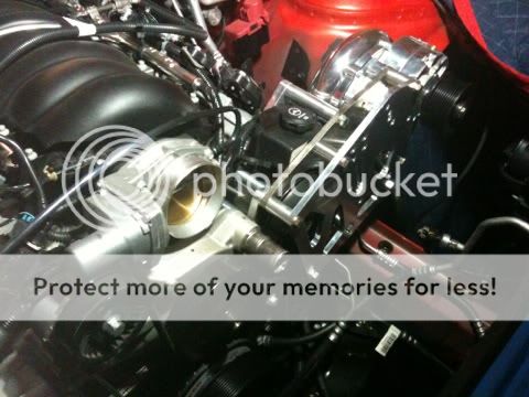

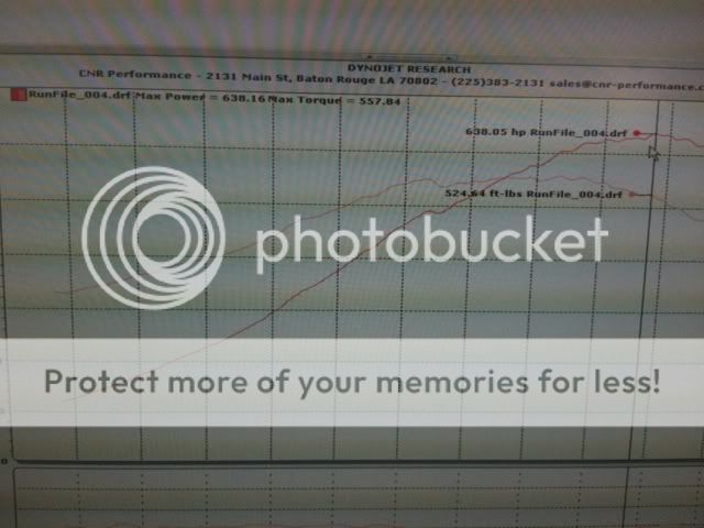

This is the SPR 2011 LS3 build from the bolt on section,well its now Vortech Equipped!!! Just a recap of the mods done to this car JRE smooth idle cam, Dynatech 1 7/8 headers with cats (which is now gutted) 2 1/2 borla touring exhaust, Vortech V3, FAST 65lb injectors and Lonnies Performance drop in dual pumps. We have the rx catch can on order along with another mod which im sure ted will elaborate on at a later date. All of the work performed on this build is by Straight Performance Racing and the tuning duties is handled by Ted Jannetty. The numbers you see is only at 8.5psi with only 10degrees of timing thanks to some bad gas and the knock sensor catching it thus the 10degrees. We will be redynoing it next week with better pump gas along with the catch can and the afore mentioned ted mod, the 8.5 psi will remain the same as its super safe at this boost level. Hope you enjoy!!!
Before.

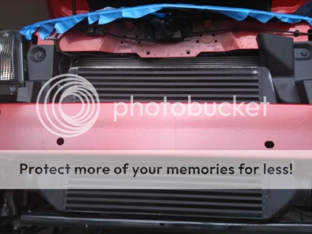

What Intercooler
Vortech Equipped
The NUMBERS!!!

just kidding welcome to the jannetty family. So jealous you got a cam.. Stealthed your intercooler. Looking to have people find out your mods the hard way?

We always paint the intercooler but the beast aint out yet just stay tune over 1000rwhp

Thanks alot bro, these cars pick up a lot with a cam more alone with a blower on top or in this case on the side. We like the stealth look on this side of the woods

I must say the work and knowledge that I received on this build from SPR(Straight Performance Racn) is incredible. The entire combination of parts(cam, headers, fuel injectors, dual fuel pump,etc) selected by SPR are working together in harmony!!!!! This thing drives smooth like a cadillac but oh boy, when you give it gas it turn heads like you wouldn't believe. The throttle response is amazing and to say that it dynoed 638RWHP with only 8.5 pound of boost and 10 degrees of timing and NO METH KIT, WOW!!!!!! Now I will eventually get one only for safety reasons down the road but the 638RWHP was achieved without it. I'm patiently waiting to see what it will do when we fine tune everything once this MAF sensor arrives and timing is adjusted accordingly. The tune on this car was by TED of Jannetty Racing who has also done a good job.

i like the clear knock retard that you can see mid pull on the dyno graph....

Yes you most definately can we plan on fixing that on friday. Will post the new graph then.
