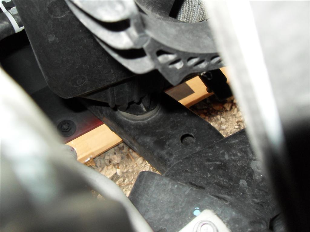

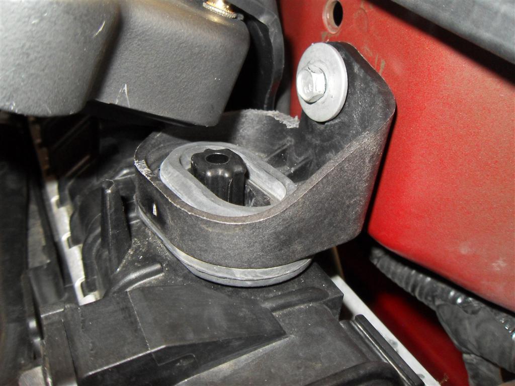

If you take a closer look at how GM has set up the radiator, you'll notice a few things... From the factory, there is some "play" built into the radiator supports. The upper brackets that are bolted to the core support have a rubber grommet that goes around the plastic posts on either side on the top of the radiator. This means that the top of the radiator is not locked in solid to the frame of the car. The lower brackets for the radiator are a similar idea. Basically, the bottom edge of the radiator has two "posts" that extend down into holes in the frame rails on either side. These posts sit in a rubber grommet also, like the top. These rubber grommets allow for quite a bit of movement of the radiator, plus allowing for expansion/contraction of the entire radiator assembly.
Some pictures of the lower radiator mounts:

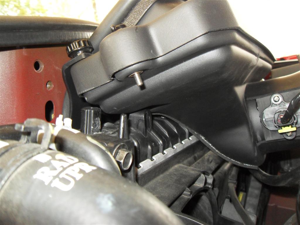

Now, here's a better side view of how the Vararam intake sits. The lower housing (the part that connects to the throttle body) sits on top of the radiator and then flows down the backside of the radiator before going to the throttle body. Keep in mind, also attached to the upper housing on the intake is the air deflector that extends down in front of the radiator. This deflector fits snugly between the radiator and the core support. Between the deflector and the lower intake housing, the radiator is basically sandwiched between the two.

If you are still concerned and want the extra security of having those upper radiator brackets still attached, you can put them back on - if you do a slight modification. I took a minute with a hacksaw to remove the section of the bracket that bumps into the intake housing. A simple vertical cut followed by a horizontal cut that aligns with the lower side of the bracket. With this slight modification, I was able to install the bracket back in it's original position...just have to remember not to over-tighten the bolt, as you don't want to crush the rubber gaskets on the intake air deflector. After taking the pictures, I removed the modified brackets since I don't really see a need to have these installed also given the way the intake itself basically cradles the upper part of the radiator. But, the option exists for those that want the extra security.
Hope that helps answer the concerns with how this intake affects how the radiator is supported.
rolnslo is offline   Reply With Quote
