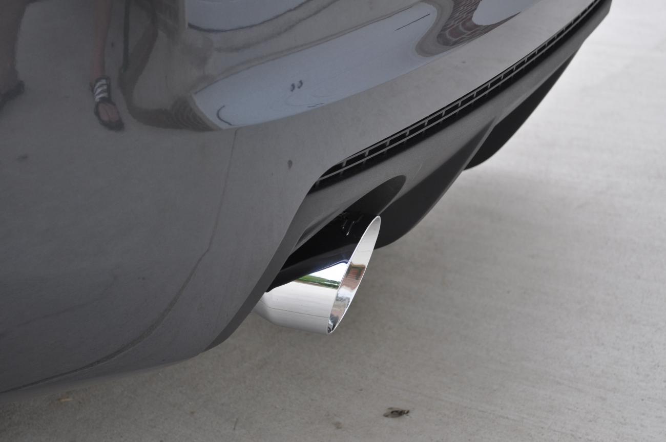

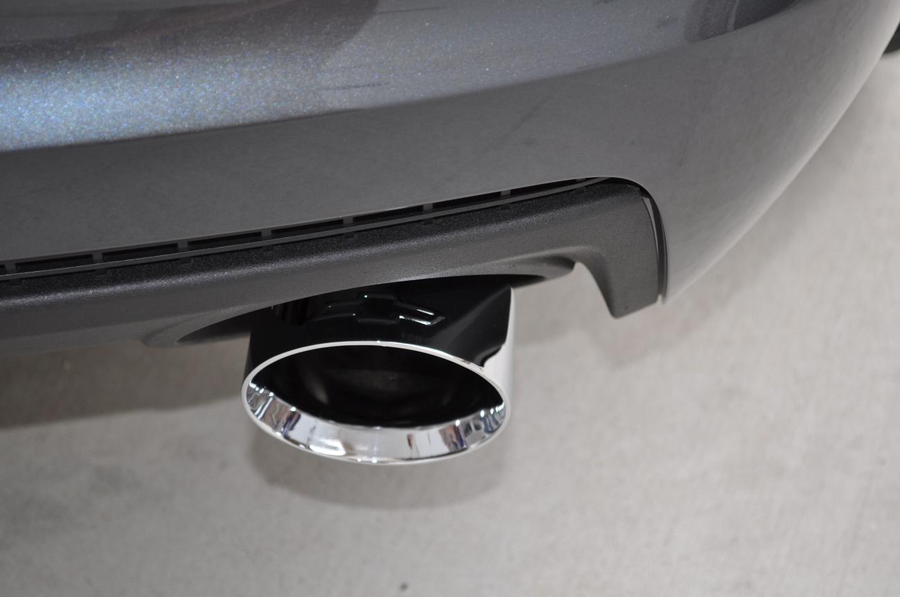

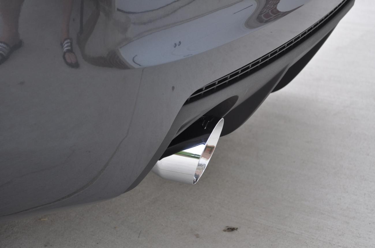

Here are a few pictures that show them a little better. Hope you get yours the way you want them.

Yep those look good. I think getting as close to how the stock ones were makes the most sense. In too far makes the diffuser look like a poor fitting aftermarket piece. Or like wearing highwater jeans.
