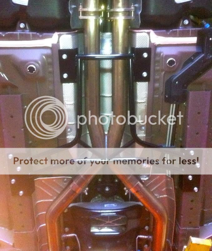

Guys, We offer a Chromoly frame brace that not only strengthens the framerail to floor but it also allows our header system which is 3" to the rear axle to fit beautifully. The remainder of our system is 2-1/2" beyond the rear axle which I will tell you is good to over 750 RWHP. I'll have Anthony post photo's of the brace with our 3" exhaust just above it. Let me know if you have any questions. Thanks.
Nick

Posts: 110
Anthony@ARH is offline   Reply With Quote
Nick
yup... see my review
http://www.camaro5.com/forums/showthread.php?t=156900
