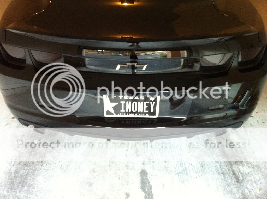

Originally Posted by iMONEY View Post
I just got done with mine. take a look at the finished product.
the before picture in my sig.
Awesome work! Love it!

Nessal
Drives: Exige, Miata, Ghia
Location: CA, Bay Area
Posts: 2,309
I read this thread today and went ahead and did mine. Took about 2 hours from start to finish. You can probably do it faster if you aren't anal like me. I taped off the tabs since I don't want those painted. This is easier than you think! Also I didn't break any tabs off which is surprising because I usually He-Man everything.
Some quick tips. Be patient when taking the tabs off. I first unlatched both top tabs and pushed them out about 1/4". Then I got a screwdriver and covered the tip with a cloth so that I don't damage anything. Then I worked the side and bottom tabs off by SLOWLY leveraging against the tail lamp. They slowly pop off one by one. No broken tabs or scratches!
Also when you spray the bezels, I noticed that the top of the bezel tends to cover faster than the lower thicker area. So you may want to go lighter with the spray when hitting the top bezels or else you're going to get runs. Luckily I noticed that the paint was thicker on the top before it happened. Also I noticed that if you get it too thick, it will start to orange peel pretty bad. Stop spraying in this area as it's done. You won't need anymore coats on it. I decided to spray in the garage because it was too windy out. It will help apply it more evenly.
Right now I'm waiting for it to dry. In 2 hours I'm putting them back on! Woohoo!

Originally Posted by Berean View Post
That looks bad ass. I think it actually looks pretty good WITHOUT the bezels. By the way, how did you take out the rear bowtie?
Nessal is offline   Reply With Quote
It looks like it has the bezel. But I could be wrong.
