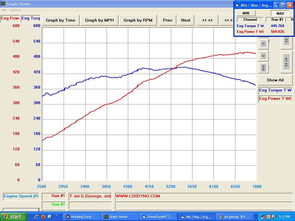

The car is a 2011 M6 LS3.
The car has the following mods done
TSP cam 231/236
Kooks 1 7/8 headers
XSPower 3" cat back exhaust no cats
Roto-fab CAI
Previous dyno before on stock 20's 475rwhp 431 rwtq on dyno-jet on stock 20's
The mod's that were added
TSP CNC heads
LS7 lifters
FAST 102
NK 102 TB
TSP underdrive pully
RX catch can and breather
This dyno with my 22' COR V4 rims, was 504rwhp and 445rwtq
Car also has, BMR split drop 1 1/4 and 1". Also has BRM front and rear sway bars.
Looking to add, axles, driveshaft, clutch, nx 200 shot. Also all BRM suspension pieces. The car will have a dedicated set of rims/tires for racing. The 22's are just for show and to have fun.
This is my old thread, about bad TUNE on the car. PATRICK G, worked his magic and turned the car around. I am super happy with the results, and will continue to send the car to PATRICK G.

Patrick G did the tune this time. I knew the previous tune on the car was not right. So I searched to see who knows and can tune the car and get it right. Patrick came to Houston yesterday, and trailered the car back to Victoria, and I appreciate the work he has done so far. I am sure he will post up in this thread about the car and tune.

I knew the car had it in it. It was the tune for sure. Just did my research and found Patrick G. We go all the way back to ls1.com days. We know a lot of the same people and he knows his stuff. Which is why I trusted him with the car. It does take a lot to find a quality tuner for sure. He knows his stuff and was confident he would get the tune right. I didn't think he would have gotten as much out of the car as he did with the 22's and planned on switching them out. He said leave them on lets see what it will do. I just don't think the 22's on the car rob much power.

It is all matter of getting the car right. I am suprised that we got that much on 22's but suspect max of 10-15rwhp max lose in the set up.

Jet offered to put the 20s back on, but I thought it would be better to do a follow-up tune with the same wheels with which he had dynoed before. This way, the gains could be attributed soley to the tune and not the wheels. Should Jet decide to go for a higher dyno number, I'm pretty sure his Camaro would punch a better number with some 20s installed.
The street manners are a lot better now, but I will spend the next couple of days fine tuning it...especially the VE and open loop tables. Fixing your PCV/catch can hose arrangement will smooth out the power delivery.
2013 Corvette Grand Sport A6 Forged 416, Greg Good ported TFS 255 LS3 heads, ECS NOVI 1500 blower, 222/242 .629/.604 121LSA EPS cam, ARH 1 7/8" headers, NPP exhaust, 747rwhp/709rwtq on 93 octane, no meth, w/stock street manners.

Very nice numbers. I'm not bashing at all but I have newer seen 2 dynos that read the same, furthermore the numbers can be "adjusted". I'm just curious how an n/a car picks up almost 30 rwhp from just a retune. Especially cause WOT throttle is the easiest part to tune in.
