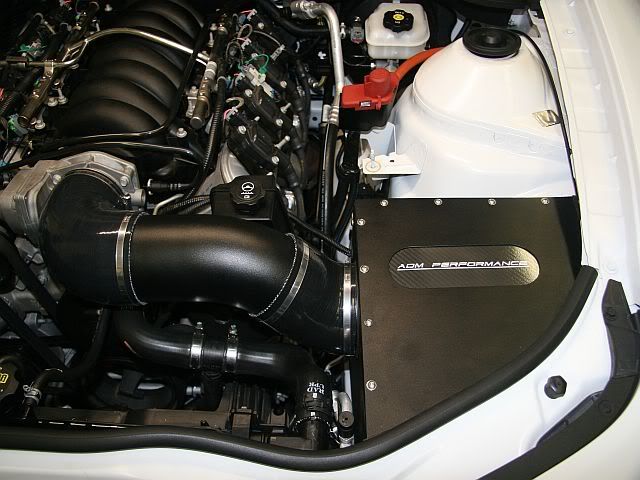

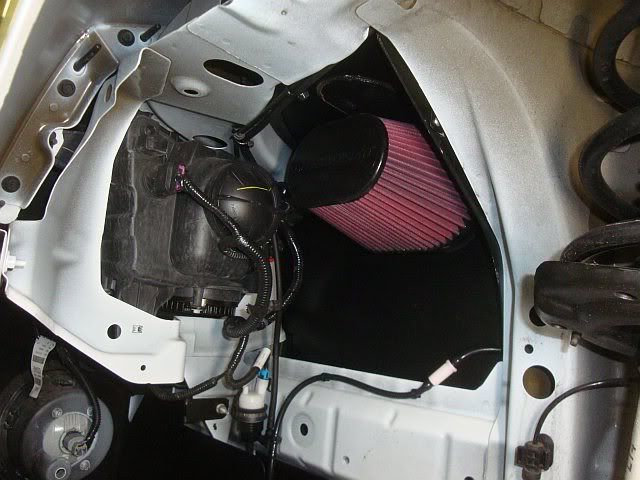

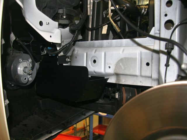

I wanted give Andy at ADM Performance a Thank You for the Great CAI and Race Scoop. This CAI is 100% Top Quality. The fit and finish are amazing. One big advantage to the ADM intake is the fact that the MAF sensor is inside the box and it has a sealed lid. The bottom is open and is fed air from the race scoop. A small and easy modification is made to a plastic shield behind the lower grille. Once removed, air has a clean path to the scoop. From the scoop the air is directed up into the air box. There are different options for the wash bottle. I am getting a Rotofab bottle that will bolt directly to the strut tower. All this will provide a Clean OE look.

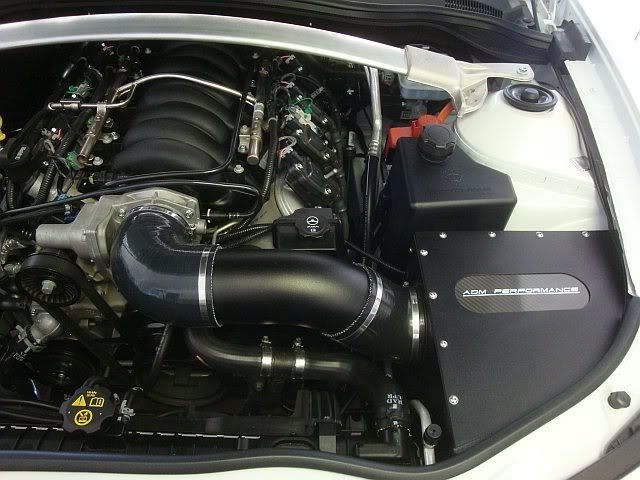

Here are a few more pictures with the Roto-Fab washer bottle and pump installed.

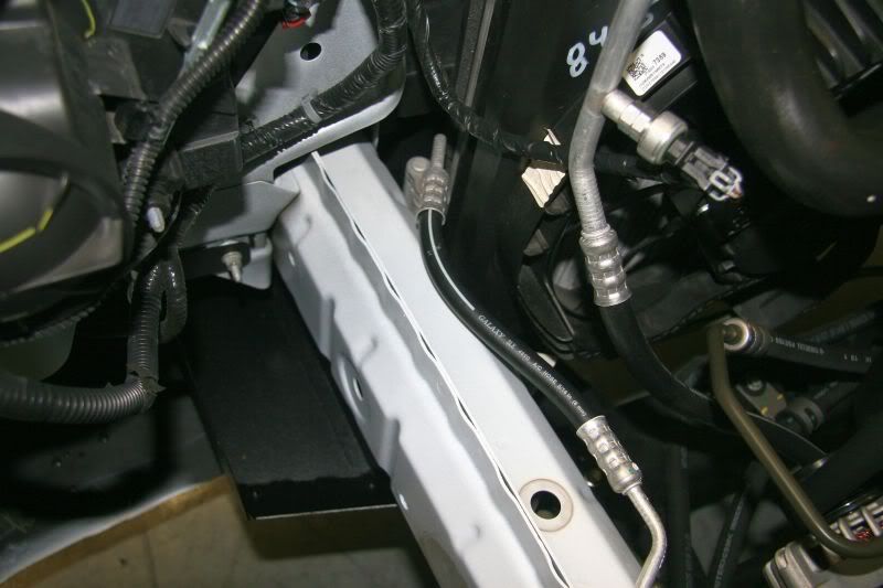

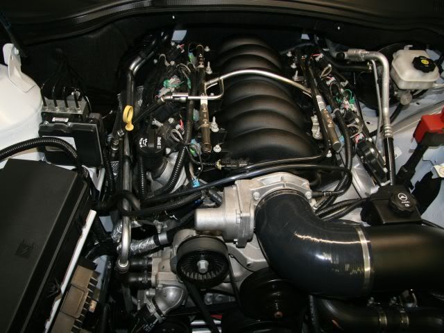

Originally Posted by Li0nel1234 View Post
MrGoodwrench,
Did you do a heater hose relocation? How difficult was it?
Yes I installed the kit from TechAFX. It does require removing the intake manifold. I have done many of these so I have it down. If you take your time and follow the directions it's not bad.
I took some pictures of the install:
http://www.camaro5.com/forums/showthread.php?t=167387
