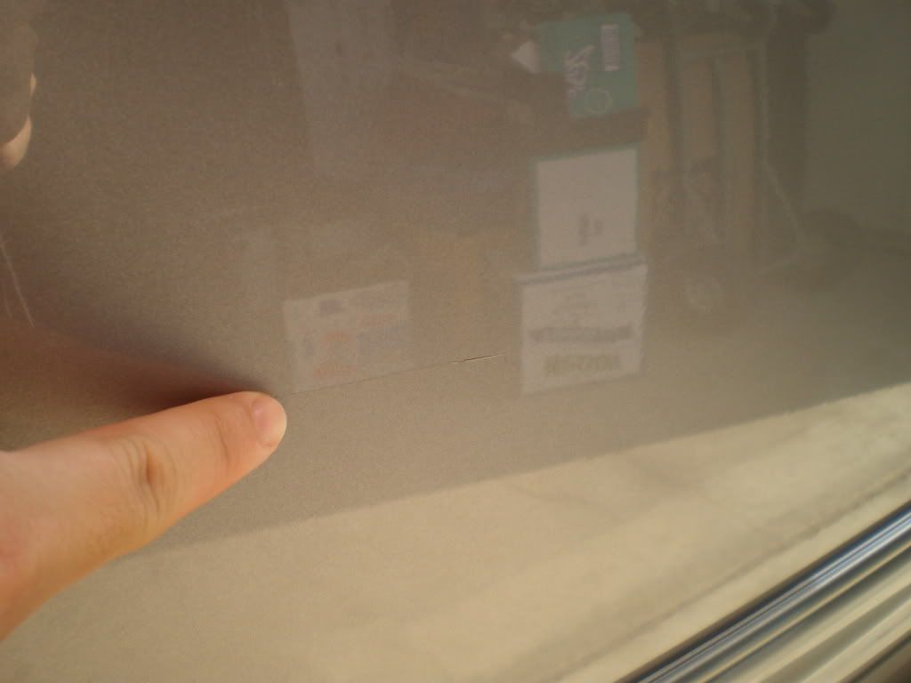

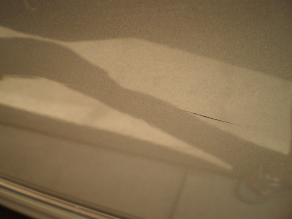

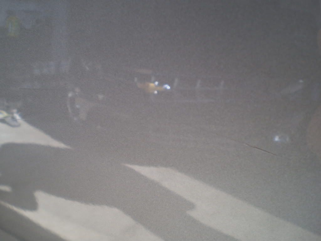

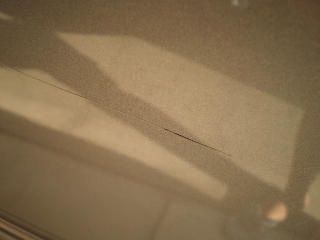

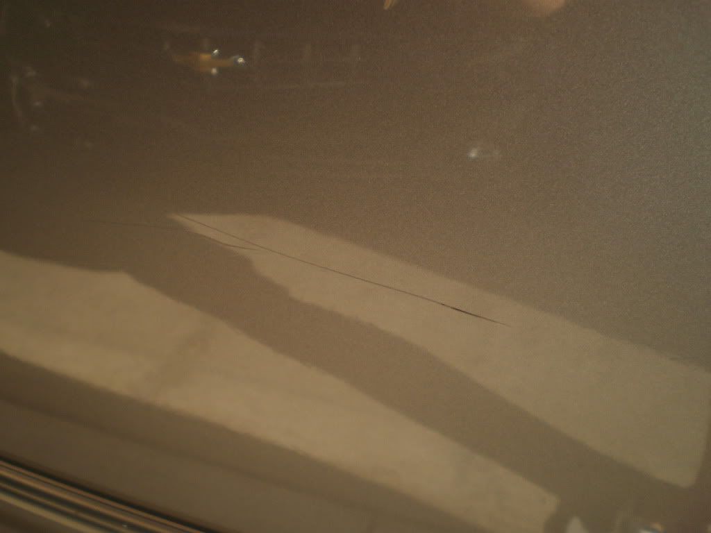

Hello C5ers.I went out for lunch today and parked in a fairly crowded parking lot. When I came back, I found 3 key marks on my passenger door of my SUV. It's deep at the starting point and gets lighter as it dragged across. I don't know what I could've done to deserve this. I parked straight and right dead center between the parking lines.
Any suggestions or tips as to how to remove it myself or any reputable body shop in Los Angeles?
Pics:
The dark line area to the right is the deep part that took away some of the paint.
I buffed most of the lighter portions out with Meguiar's Rubbing Compound. Gave it some Meguiar's Polishing Compound and Cleaner Wax after I removed all I could.

I'm sorry but after looking at your pictures the only way to fix these will be a re-paint. The paint has been chipped down to the plastic or primer depending on where this is on your SUV.

i paint for a living.. from what i see they look pretty deep in some spots.. can you feel them with your nail? if not then a wet sand a polish may work, but those look bad.. is it down in the paint to the metal? if they are then your only option is a re paint or a touch up which will not look acceptable to me.. if you have full coverage insurance then put a claim in.. they should cover it.
Yea I already buffed out most of the smooth areas with rubbing compound.
What you see left is the deep areas and you can feel with your fingernails, quite deeply, sadly.....
I think it got through to the metal because this is a 10 year old car and the paint if starting to chip off...
I do have full coverage through AAA. Would they possibly raise my premium if I have them fix something like this?

if its to the metal then its a hopeless cause unless you deal with a touch up or just get a repaint.. as for insurance, you can give them a call.. tell them someone took a key to your car in a parking lot and you would like to know if your full coverage would cover this and whats the risk with a insurance raise.. from what iv dealt with in the past at the shop, most insurance company's wont raise you because you are not a fault for this and its considered vandalism.
