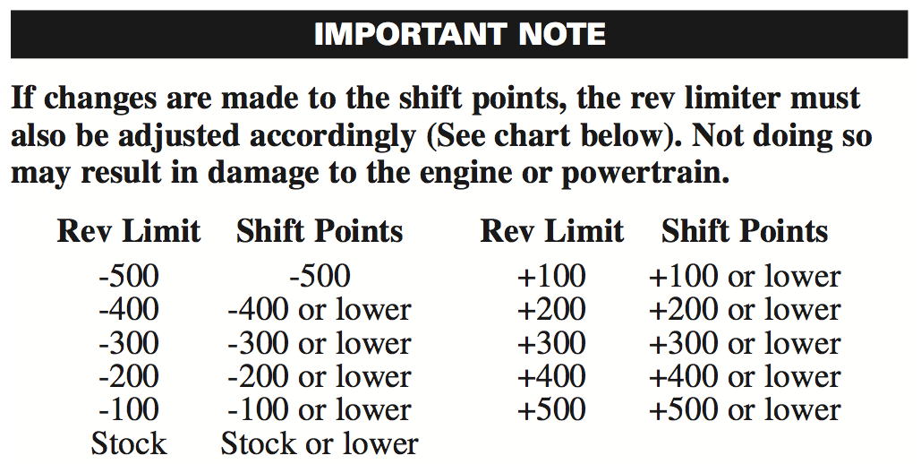

TRANSMISSION SHIFT POINTS (AUTOMATICS ONLY)
The shift point option allows the user to change the RPM at which the transmission shifts at wide-open throttle to find the very best shift points for maximum acceleration. For shift point optimizing, test only one (1) shift point at a time until the best RPM shift point is found for each.
TO ADJUST TRANSMISSION SHIFT POINTS, PRESS Y TO KEEP STOCK SHIFT POINTS, PRESS N
When ‘Y’ is pressed, this screen will appear:
USE UP/DOWN ARROWS TO ADJUST SHIFT POINT. THEN PRESS Y TO SELECT OR N TO EXIT 1-2 SHIFT _ _ _ RPM
Press the L arrow once for 100 RPM, twice for 200 RPM, etc. and then press the ‘Y’ button to enter the 1-2 shift point selection. If there is no change to the 1-2 shift point, enter a zero, and press ‘Y’. Use this same process for each of the shift points in the vehicle. The shift point adjustment range is +/-500 RPM in approximately 100 RPM increments for each of the shift points for the vehicle.
Name:  Screen shot 2011-09-30 at 7.49.45 PM.png
AUS10BMX is offline   Reply With Quote
Old 09-30-2011, 10:33 PM   #180
BSR-1
BSR-1's Avatar
Drives: 17 ZL1 M6 Black
Location: Capo Beach, Ca
Posts: 1,411
Attachment 292463
I'm not sure I understand why?
Unless you set the shift point higher than the rev limit so that it would never be able to shift I don't get it.
Even more so for the lowering of the shift points. Why would you need to lower the rev limit?
Anybody with any Ideas?

The stock rev limit is set at 7000 rpms (I'm pretty sure about that). I would NOT increase the rev limiter on this enigne as it quits pulling past 6900 rpms anyway and with as flat as the power curve is, I doubt you would gain enough to warrant the extra strains on the engine going more. As far as increasing the rev limiter because you increase the shift points, I'd suggest finding the shift points of the stock tune and then only change the ones that need changed. I doubt anyone will need to increase the 5th to 6th gear shift points or even the 4th to 5th unless you have changed the rear gears. With the factory speed limiter set at 155 on the RS cars, you can hit that in fourth gear (on the stick cars at least) so no need to change shift points above the speed limiter IMO. I have the stock gear ratio's and stuff for the auto but it's late and I'm too lazy to find out what speed you would be at in fourth gear at 7000 rpms, but it has to be pretty close to the 155 mph limiter. So in short, test the 1-2, 2-3 and 3-4 stock shift points and then adjust from there to start.
As far as shift firmness, again start low and work your way up. I love a good solid tire chrping shift as well, but I think you can get that at 25% or 50% increased. If it takes 75% to get a solid shift then go for it. I do not have an auto so I can't test and give any real data other than recommend not to take it too far and start stressing the rest of the drivetrain.
