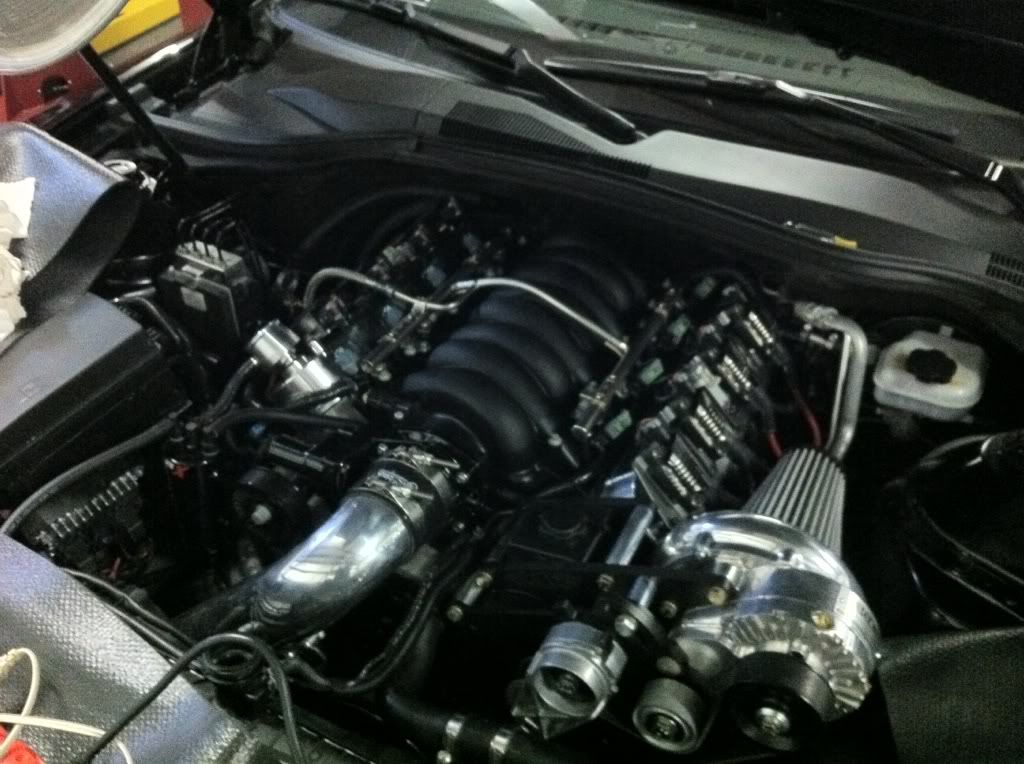

Originally Posted by ackeight View Post
do you remember what the PN's were for the fuel lines from summit? I thought I saw on mast's website they still had them. I guess the only way to find out is to call. I'm not all about the colored fuel rails that everyone has except for the black ones. Thx
Here's what I got from summit plus 2 fuel rail plugs and 2 -6 AN fuel rail fittings from MAST:
FRA-810006 Fragola Push-loc -6AN hose
FRA-209006-BL Fragola 90 degree -6AN Push-Loc fitting
FRA-200106-BL 2x Fragola -6AN Push-Loc straight fittings
EAR-AT925106ERL Earl -6AN Tee
That's all you need to tee off from the back and crossover in the back + clamps.

Originally Posted by 67motorcat View Post
My Engine cover has been off since the day I brought it home....
Since then I've done a few things I think GM should have done.
(1) Home grown heater hose relocate.
(2)Fuel rail flip with Corvette fuel line.
(3)Clam Shell removal.
(4)Re-locate Evap Valve and related hoses.
(5)Remove Coil brackets and mount coils directly to Valve covers(Holley)
(6) Re-route engine harness where it splits around Oil fill Cap.
Other stuff as well but I think this is a great improvement visually with the cover removed.
I'm going to bug you one more time. Let me get this straight how you did this. I may make a DIY for everyone who wants to do this.
You used the 90 degree fitting on the driver side rail. The T fitting on the pax side rail. and the straight fittings for the fuel inlet hose? You obviously cut the hose to length. What clamps did you use? Sorry for bugging you so much but your setup is badass and the way it should have come from the factory.
The two straight barb fittings were for the tee since the tee is just a female -6AN to two male -6AN's. I put the straights on these male parts. Sound's like you got the rest. You can use any hose clamps you want, I just used some I had lying around. You probably don't even need them (except for the original fuel outlet hardline) since it would be hard for me to pull the hose off if I used my full strength, but I definitely feel better with them on.
You could also go with stainless braided hoses but I decided to use pushloc hoses since stainless braided hoses stunk up my last car with the smell of gas after some time. Though some would say they look better.
Make sure to use Teflon wrap on all the fitting connections. Good luck

Originally Posted by ITGuy11 View Post
Here is the idiot question of the day...How do you remove the clamshell? The long bolts hit the underside of the cowl when trying to remove them.
Unfortunatly, the intake mainifold has to be removed or (slide forward) to remove the rear bolts completely.
After the brackets are removed the first time, the manifold can stay in place if you ever want to flip or remove the fuel rails seperatly.
