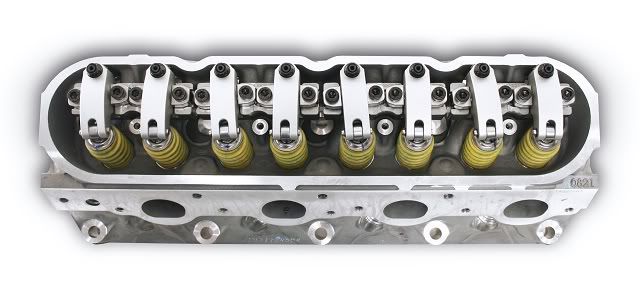

Junk the factory rocker arms and the trunion upgrade. Jesel is the way to go.
Wow, now that sure is "purty"!!!!!
