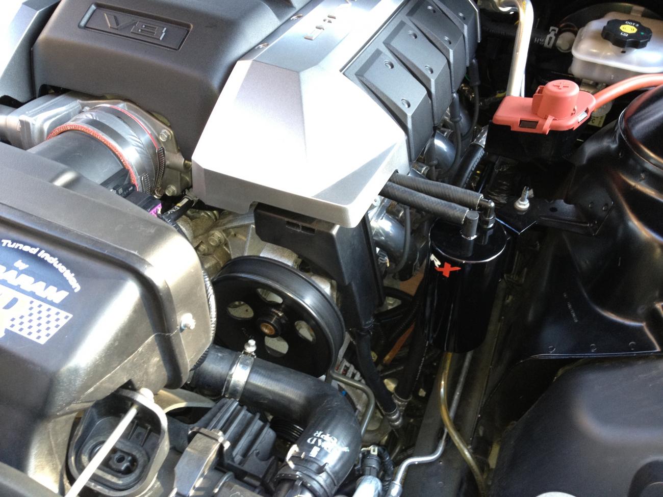

Im surprised that it was the frozen valve. Wouldnt the "air" being sucked thru the PCV system be warm enough to unfreeze the frozen valve?
I would think if the valve is frozen, no air is moving through the tubes, even it it is warm. There is not much heat conduction through the rubber hoses. The engine compartment needs to heat up to warm up the valve and can.

Originally Posted by bannonm View Post
Can someone clarify this statement made by SC...
"we find a high percentage accidently open the drain valve. he drain valve is CLOSED when the thrreads are all the way exposed and extended, and open when the threads are retraceted and not all visable."
As I'm sitting here at lunch reading this, I'm concerned my RX can is open. Looking at the bottom of the can, if I turn the valve clockwise is the valve shut? As any normal valve, if I turn it CW the valve closes. Sounds to me like this valve on this can is opposite. So again, looking at the bottom of the can turning the valve CCW actually is closing the valve?
I just put this can on a few weeks ago but only have less than 100 miles on it. I started smelling the faint smell of burnt oil while driving and now I confused if maybe I have the valve open and that's what I'm smelling. And no I don't have the hoses flipped.
OK. If you are looking into you engine bay - so you're looking at the top of the RX catch can. Turn it to the left to close it. Turn it to the right to open it.

Why do you say you have to mount the cc there with the vararam? I have installed a few of the RX cans on the motor with the vararam?
I did not say you have to mount it there, conceivably you can mount it nearly anywhere. Where freezing is not an issue, mounting it in a cooler spot would help the hot gases condensate.
Mine wouldn't fit there and why it's mounted to the water bottle. Tracy has since made slide adjustable brackets and what I've been calling a hockey stick type. I could have drilled holes and made mine fit but didn't like where it would have sat.

Originally Posted by SC2150 View Post
MA2010 is correct. In cold climates the cans will catch a good amount of water as well and if left to get to full can freeze if it is well below freezing. Also, the checkvalves themselves can if moisture is trapped in them. When draining, make sure to have the engine warm and then with the motor off, open the drain valve and allow it to drain for 3-5 minutes (less in warm weather).
With the cans mounted to the cylinder head they warm up fast, but on the drivers side air box stud mount it is further and takes longer to warm.
To see if all is working correctly, with the motor idling, pull the line loose from the crankcase vent and fell for suction. If you have suction then all is fine.
I read through most of the thread but I want to make sure I'm clear on things.
My vehicle is my DD in Michigan. I have my can mounted in the standard position in front of the engine. Do I have anything to worry about with the can or would I be better off going to a non metered valve? I just want to make sure I'm not causing any trouble.
