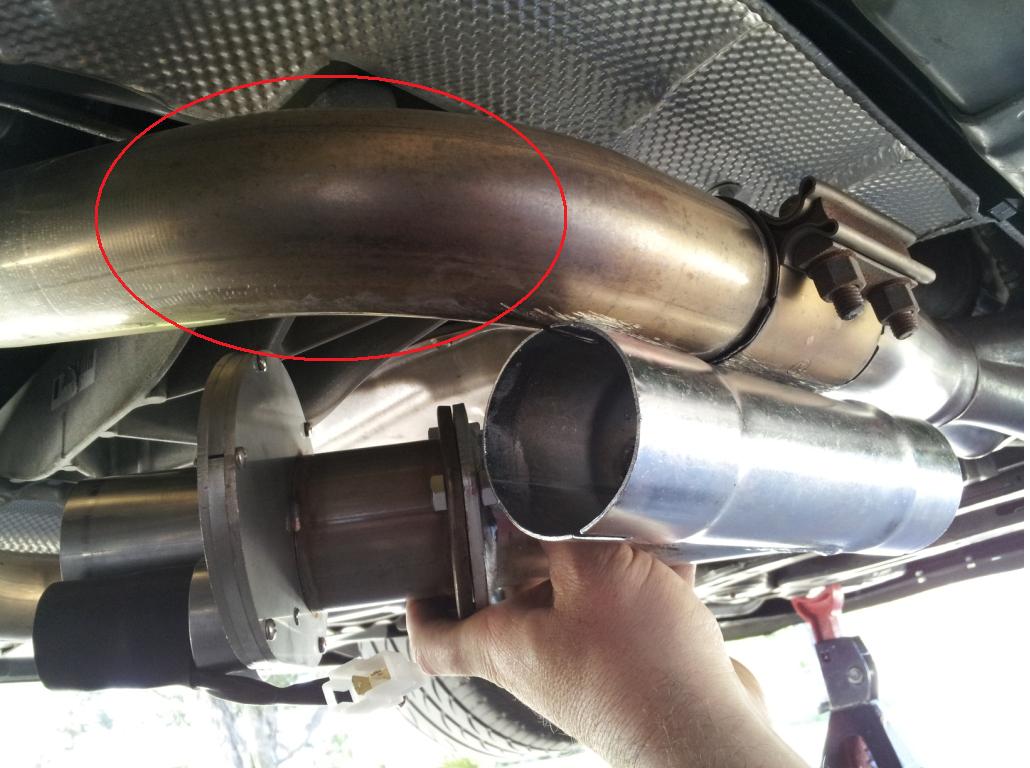

Problem is the style of cut-out.
The big 'blade' part is the pita.
The red below hits the pipe just like the pic shows.
The Yellow the pipes curve too fast and so that part is not long enough. Even if I cut the 'Y' pipe a sleeve clamp won't have enough to bite to.

The cutouts you bought look big compared to some others I've seen like QTP or DMH. That makes them harder to mount, especially if you're not willing to cut up that Y pipe and weld them in. I'm no expert though and I cheated by having my shop cut them and weld them.
Attachment 343705
Two questions:
1) Where are they supposed to mount as designed?
2) Are the flanges perfectly circular - allowing you to drill new holes, if need be and twist the motor assembly 180° (letting the "big blade" fit)?
Old 03-04-2012, 11:29 PM   #2576

Two questions:
1) I think on a truck.
Meaning they are not shaped or designed for a tight and low fit.
2) There are 3 positions on a triangle. Only three bolt holes.
