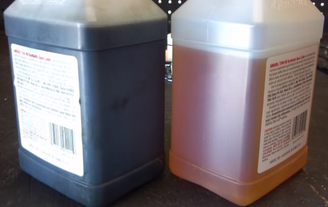

We just hit 1,500 miles on the car and since the manual recommends changing the differential fluid at this point I did it last night. And I am astounded by how much metal was in it!
It looked like liquid metal pouring out with a fair amount of little shards stuck to the magnets in the plugs.
If you haven't changed it I would highly recommend you do it. I'm personally going to change it again at the next oil change.
Interesting. I didn't change ours until 20,000 miles and there was very little "metallic look" to it. Don't buy the subpar/inferior/over priced dealer fluid. You can get the best for less if you do your research. And even if the fluid "supposedly" has the LSD additive already in it, buy some anyhow and add it to save from crawling back under the rear end to add some because you have chatter.
Old fluid in the bottle on the left with 20,000 miles on it. New that went in on the right.

Now he says that mine is an automatic so I don't have a clutch to create the debris. What say you to that?????????????????

LOL well it doesn't matter what trans you have since the differential is a completely separate component in the back of the car. It's a good idea to change the diff fluid relatively soon after you get a new car, but not absolutely necessary. The reason you should is to clear out any shavings or debris that might have been left in there during assembly, and the very small amount of metal particles that are worn off the gears during break-in when the assembly is new and the parts are wearing against each other until they've smoothed out the contact surfaces.
If you don't change the fluid the diff will still work and work for a long time. However those particles that are in the fluid get picked up and wash through the gears which can cause them to wear faster than they would otherwise. If you're racing then you should definitely change the diff fluid. In fact, according to GM you should change it every 6 hours of racing because the high heat in the differential causes the oil to break down much much sooner than under normal everyday driving.
There's also the benefit of the more "expensive" and higher quality oils reducing friction in the diff which not only lowers resistance and allows more power to get to the wheels, but that also lowers the heat and helps the gears last longer. By "more expensive" we're talking maybe $20 for a bottle? It really isn't expensive at all and if you race, it's actually pretty cheap insurance to protect that part of the car.
