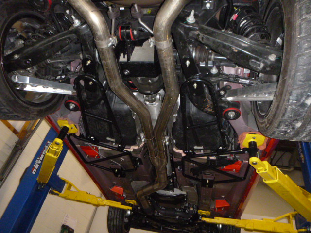

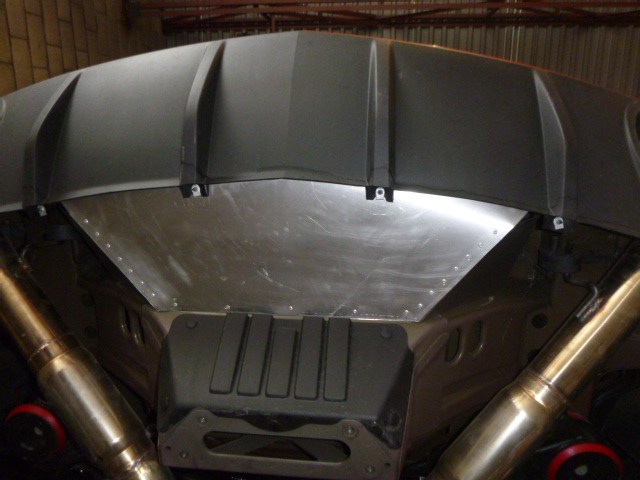

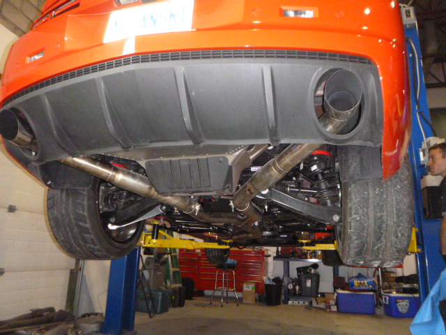

We put on an aluminum pan to keep the air from getting under the rear bumper cover while going down the drag strip.
Also look at the last pic, and focus on the black subframe connection bars.
Along with the roll bar the car is quite rigid.

What is the plastic behind the diff an in front of the rear pan??
