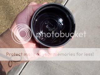

So I have finally driven the car over 1000 miles (just over 1100 miles actually) with the catch can on and below is what it has caught. I would say that it is working pretty darn good.
That looks like a lot of metal flakes..
It's from the threads when screwing the bottom of the can back on, I started cross threading it and caught myself.
Edit: It's also from my multiple times of unscrewing the bottom half to check what has been caught.

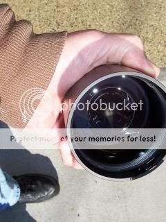

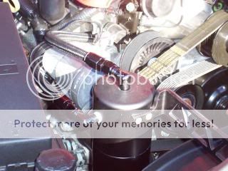

Installed at 71 miles, now have 313. Seemed pretty easy, but (for me) nothing ever is.

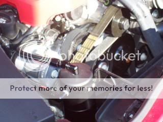

I assembled the can first and attached it to the bracket. Then I took off the stock PCV line, not too bad after moving the bracket above the line (as suggested in the instructions). Next I placed the clamps on the hoses loosely (used the braided hoses) and installed the bottom first, then the top. It was difficult but doing it this way I was able to spin the hoses while pushing them onto the connectors. Got the hoses on as far as I could, then it took a lot of patience to tighten those clamps. When the clamps were tightened up, I attached the can and bracket in the appropriate location using a 10.9 grade bolt, 5mm longer than stock with washer to allow for the bracket being there. Finally I attached both hoses to the fittings on the can and done!
Pics show what I collected after 242 miles.
Installed.
Bolt. I have some additional bolts/washers if anyone is interested. Glad I got this product, thanks Chase!
