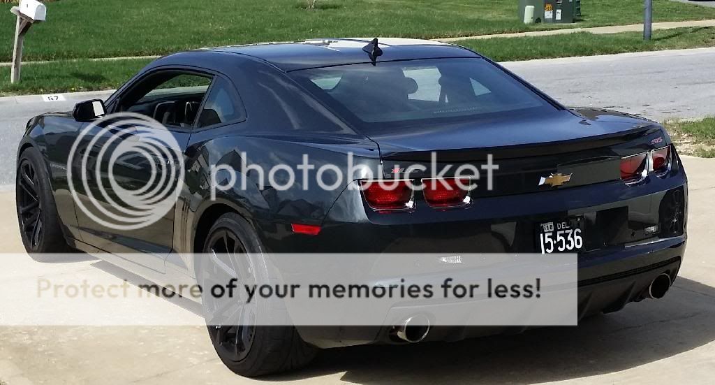

Posts: 1,220
TSP headers, cat delete, x-pipe, atak, RPM custom cam and tune, Phfadt 1.25 springs, 15" Carlyle conversion, Nitrous Outlet, Procharger F1A-94, Meth inj

Originally Posted by canecorso69 View Post
Damn it does looks nice

Posts: 1,220
The ride is firmer which one would expect but the overall look is insane. Ride quaility is not sacrificed IMHO
