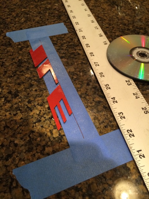

1) I taped one long piece of painters tape sticky side up, shown in 1st pic.
2) I used the Fine Point Sharpie to draw a straight line on the tacky side, 1st pic.
3) I placed the "E" down first(metallic surface face down) and worked my way over to the final "1", 3rd pic. The red tape is the back of the emblem.
4) This is key for spacing: I used 2 DVDs(pancaked together) between each piece. You could use 1 DVD, 2, or 3 depending on your preference.
5) Pic 3 shows the final placement of the "1LE" - this is the Small emblem that I put on the interior panel. * Again, used 2 DVDs for spacing on this small emblem. *

7) Pic 5 is the final placement of the aligned emblems onto the panel. You can work with this to see exactly where you want to place the emblem before you peel the red backing off the back of each emblem. Once I peeled the red backing off I had to eyeball the alignment of the emblems to make sure I had them in the center of the panel(top to bottom).
8) Next, apply medium pressure to the emblems once they are stuck to the panel. Then, I used a hair dryer on the emblems to warm them up a bit, just to be sure there were no adhesion issues.
9) Pic 6 is the completed project. I peeled the blue painters tape off at and angle approximately 15-20 minutes after I pressed them onto the panel.
