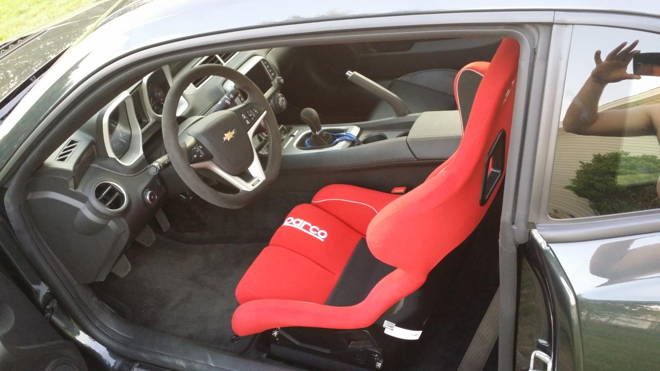

Hey Lio thanks for helping with my seating decisions. Maybe I can help now. I ordered the 600 series base, the sliders and the side mounts. And if you put all of them on it actually sits higher than the stock seats.
So I ended up fix mounting it the the base with the side brackets. Which is no big deal since I'm the only one that ever drives it.

You will need a Torx T 50.
No I haven't got harnesses yet as I have nothing to mount them too.
And I haven't done anything with the air bags yet (just clearing the light in the DIC)
It honestly wasn't very fun because the whole reason I was doing a seat was for head room. If I was short and would have used the sliders it's all straight forward and 100% boltin.
I had the seat in and out of the car literally 20 times. And had to drill some slots in the 600 series base. But anyone that isn't illiterate should be able to do this in a day. I suggest using the help of a willing friend.
All in all it took about 5-6 hours.
Just trying to find the right spot for the seat. Remember measure twice cut once. Well I measured probably 20 times and only had to drill 2 slots like the ones on the 600 series base. FIND TWO HEX HEAD BOLTS TO MOUNT THE BASE IN THE CAR THE FACTORY ONES DON'T FIT UNDER THE EDGES OF THE BASE. And if you do manage to get them in you will not be able to get the torx T50 on them.
As far as harnesses go after driving in this seat the only reason I would need something to hold me in better would be if I were braking Really Really hard.
Feel free to ask more specific questions. Hope this helps

I don't know the stock seat weight but it was full power and heated so probably 65+ new seat is 19 and brackets are probably 5. I'll estimate at a 40lb loss

Just an FYI...My 1SS, non-leather, non-heated power stock drivers seat weighed in at 44Lbs
