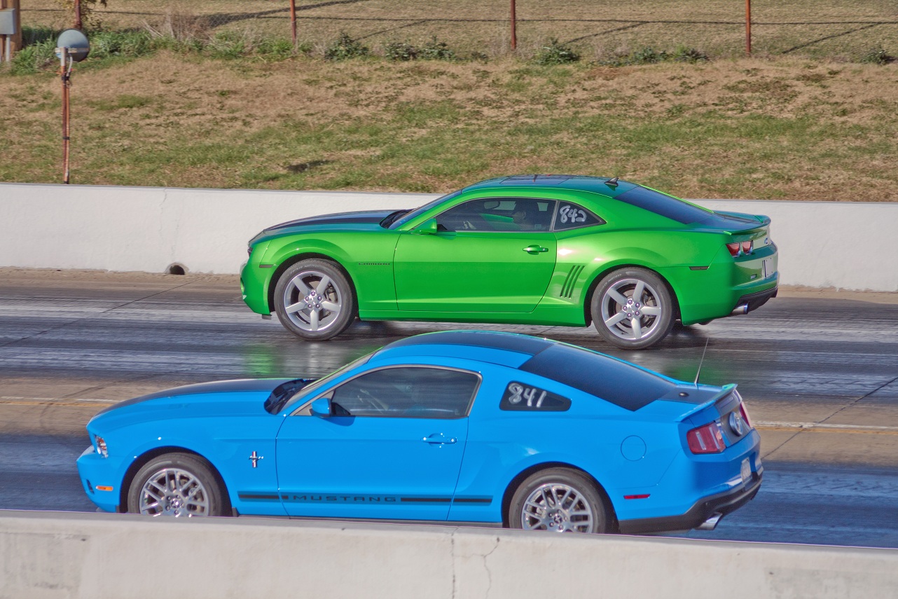

About 2 years after we bought my Camaro, we bought my wife a 2012 Mustang V6. She is the one that dragged me to the track to race her when her car was stock and I was modded. When our cars had the same mods the races were intense:
Camaro V6 = 11.268 @ 120.11
