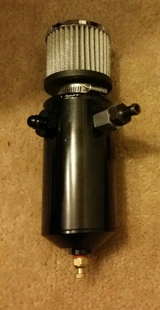

+1 and their cans aren't built properly. After a few boost pulls they begin to rattle internally causing check valve failure and blow by.

Yeah take Sycraft advice many of us switched to the MM PVC can (for boost applications) and are HAPPY!
Attachment 683542
Sent from my HTC One_M8 using Tapatalk
i'll call him. my biggest thing is that it needs to be a bolt-on solution

It is. His name is David Childress get a boost can and a breather
