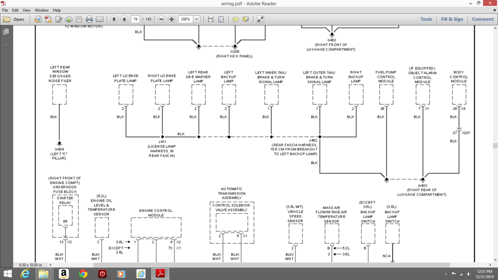

here is the ground circuit.
maybe the ground is broken at the left side marker.
J=splice
G=ground connection to chassis
