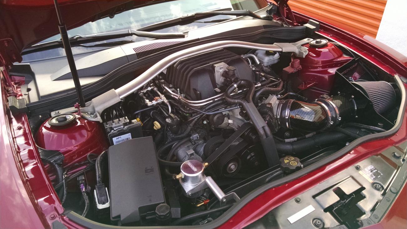

Stage 3 Dyno results - 718 hp / 661 tq in the heat
Added 2" Kooks LT's and E-85 flex fuel. Car made 686/631 on the same Dyno in cooler air with factory manifolds.
Ran out of pump on E-85 even at a 30% mixture. Gained a little torque but only 3 HP. So we have to address the fuel pump down the road before I hit the track on the flex tune.
Car made 715/649 on blower only. Fasterproms install and Formato tune. If the driver does his job, car should run well in good air. Hoping for 134-135 trap speeds on blower only.

Awesome numbers Chett! I've been thinking about an Flex/E85 conversion for a while now. Those pump upgrades aren't cheap though. What injectors are you running?

Thanks Marty! ID850 injectors. We kinda expected the stock pump would be a problem with E-85 on this combo. We were hoping for a little more. Not ready for full blown squash. Boost a pump might offer a little more head room down the road.

Thanks Man. Can't wait to see the track MPH on this combo and yours. And how in the World are you staying on the stock pump at your power level??
Looks like I'm tapped out. Any other suggestion from high HP Guys on success with a boost-a-pump at over 700 rwhp, please chime it.
