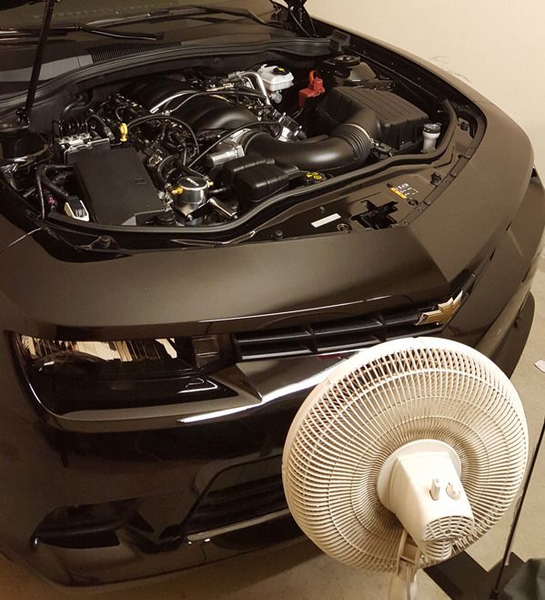

Ordered Z/28 CAI and then went for a cruise.
Returned home to cool off. 100 out there today.

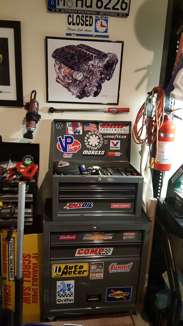

Then I did some interior decorating.

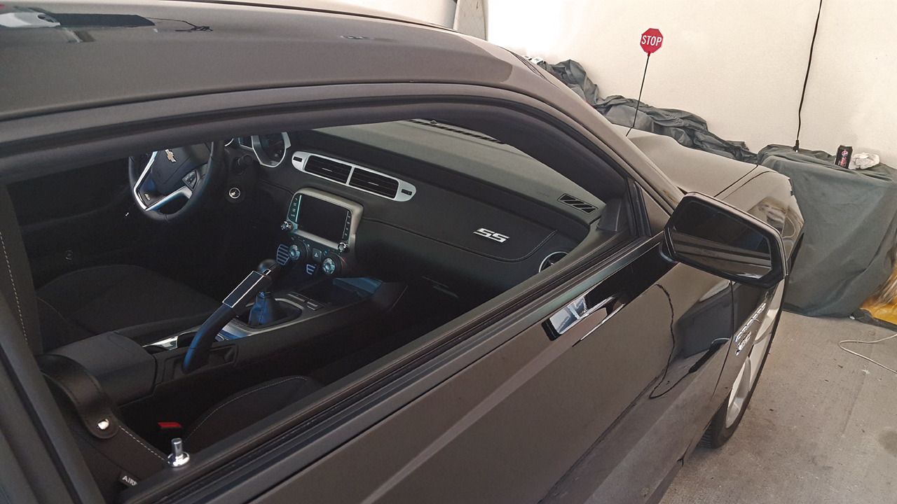

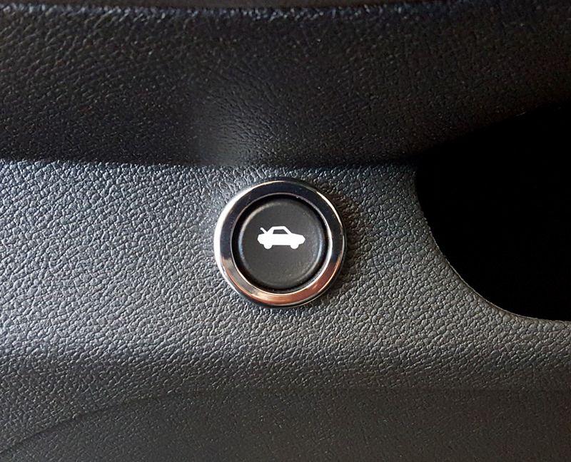

Did a few small things today.
Installed GM Performance pedal set.
Also installed billet e-brake handle cover, radio knobs, cup holder cover and door locks. Put an SS trunk lid emblem on my dash too.
Billet trunk button ring as well. Need to get the one for the mirror controls.

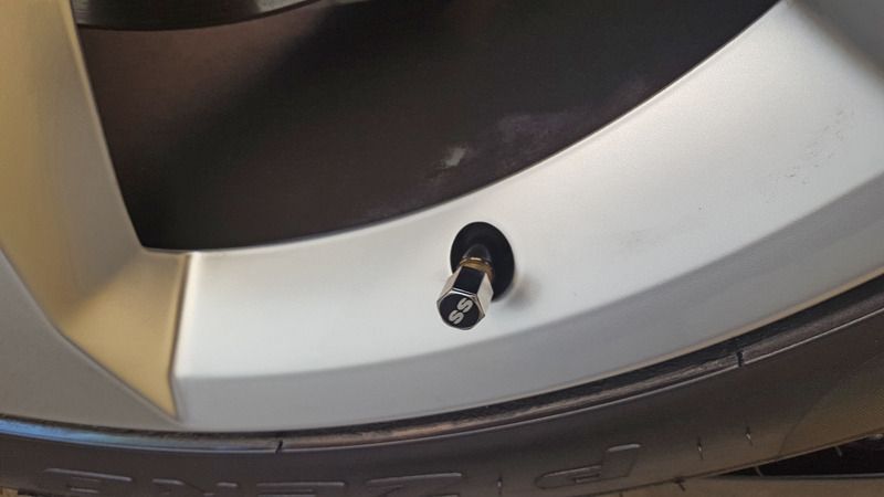

GM SS tire caps, why not?

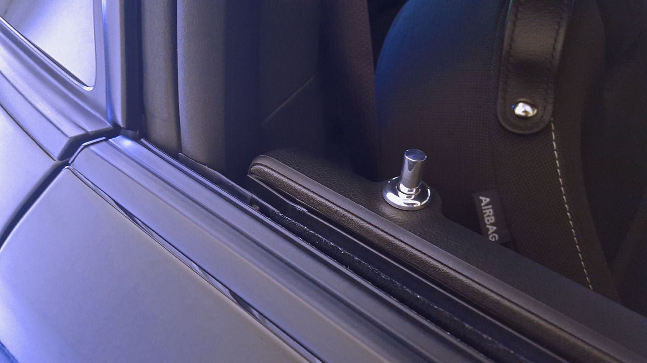

Have to say the billet door locks are my favorite mod so far. They have a very solid sound when you lock the doors and are visible outside the car.

Got them from PHASTEK. $29.95 on sale, use your CAMARO5 member discount too. They have several finishes including painted. I prefer the polished look. Not sure how the painted ones would hold up.
http://www.phastekperformance.com/20...ock-bezels.htm
My tips for installation:
Don't use tools to remove the old ones or install the new ones. This way you will avoid scratching your interior and it's also unnecessary. Use a paper towel and grip tightly with your fingers to remove your stock door pins. The stock pin bezels (the part that the lock pin protrudes from) is made of rubber. Using your finger push one side of the rubber bezel against the door and it will pop out. Put a towel over the new aluminum bezel and tap it in. You might have to reposition it a few times, but it's no big deal. Tighten the new door pins finger tight, I also used a touch of blue Loctite. Note that the door pins are interference fit. That means they don't thread on cleanly, the same is true of your plastic pins. Just snug them down by hand and you're done. The new pins sit slightly higher which is normal. Enjoy!
