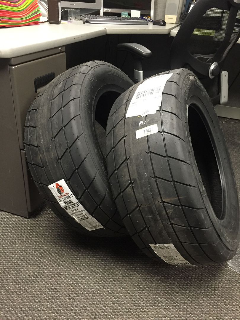

Tires made it in.

Originally Posted by JantzenOKC View Post
Tires made it in.
Ooh you went big. Mine showed up today too!
275/50/17
275/50/17
come on guys you can go bigger lol
Nice!
305 is probably a little overkill but oh well. They feel so soft though, I can't wait to hook these things.
