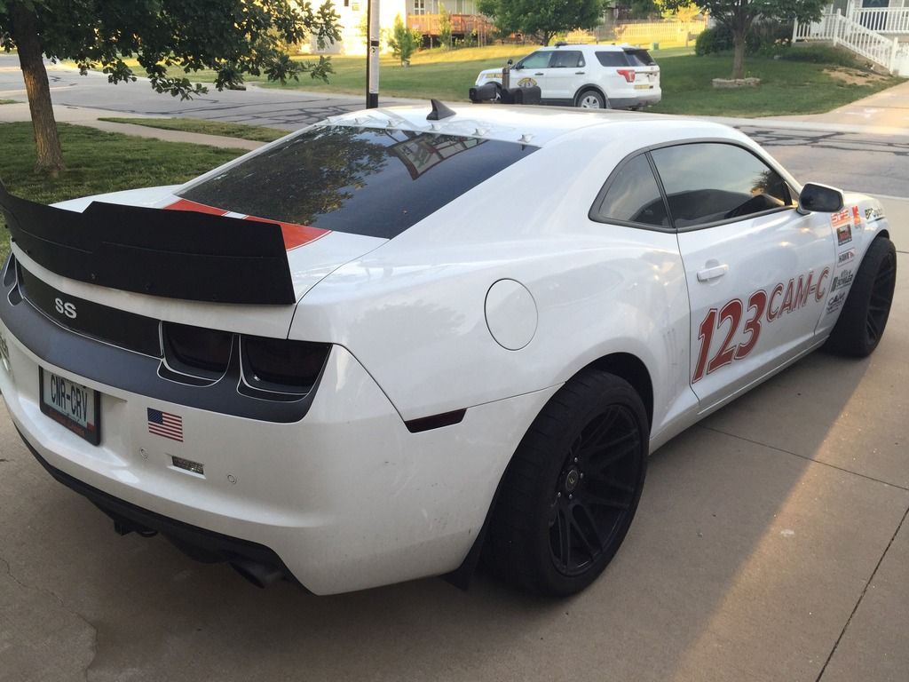

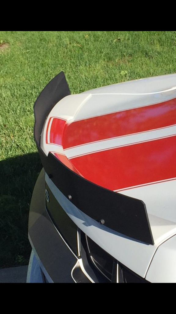

This might be out of scope for this thread but that spoiler you have in your sig is pretty sizeable. What is that? 6-7"? Depending on what's being considered as high speed...aero balance looks biased rear. Might consider trimming size or adjusting attack. Or adding a splitter to the ZL front end.
I'm allowed 10" in ESP but the car is being built for NASA American Iron long term. I think I'm going to hold off and toss on a wing of sizeable cord.
We are allowed 8" from original body in CAM no wings. This is just a piece of .088 aluminum sandwiched in between my 3/16" homemade aluminum wickerbill and the original spoiler. Attached with rivnuts into the original SS spoiler. I really only use the large one for autocross and the small one for street and track stuff
