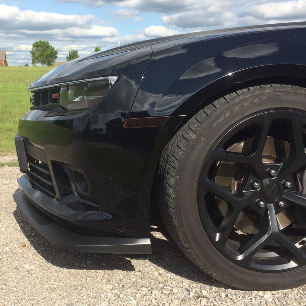

Does it sit lower yes... Does the front splitter stick forward a bit... Yes. Does it make inclined transitions difficult yes.... Is it worth it???
I think it looks great. I am glad I didn't do the 1.25 inch. I think the 1" has been perfect, not to mention my rear driveshaft angles stayed more in-line. I can still align inside of factory specs without other suspension parts.
If you like to jack the front up with a single jack, you will need to drive up on 2x4's or something first, just to get the low profile jack under the front.... I now have race ramps. Make sure you get the 6.6degree approach.

The only issue is really that front point, you know the type of roads your normally drive on. The car is my wife's daily driver, she is extremely careful and does her best to pay attention to entrance's and exit's. She scraped the front tip the other day leaving a parking lot to get to the road. You are only talking about a 1/4" lower... But at some point there is a limit. We do have the extra weight of the LSA in the front and the extra weight of the ZL1 rear diff in the back. Not sure if that squats her down a 1/4" but it is worth noting and may have the car a little lower than a typical 1" drop.
FWIW those pictures were taken before both of those mods.
