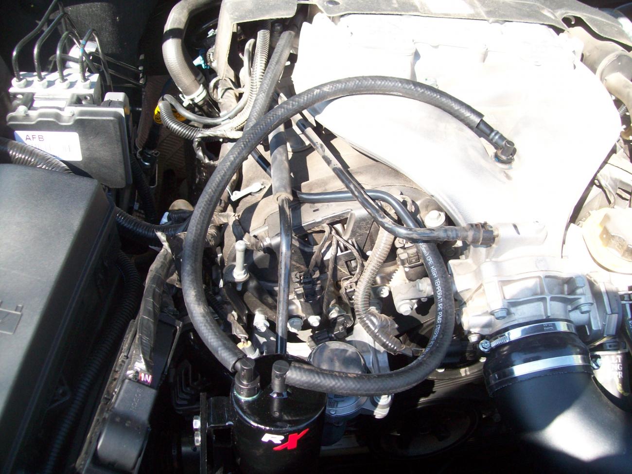

Here is how my routing goes

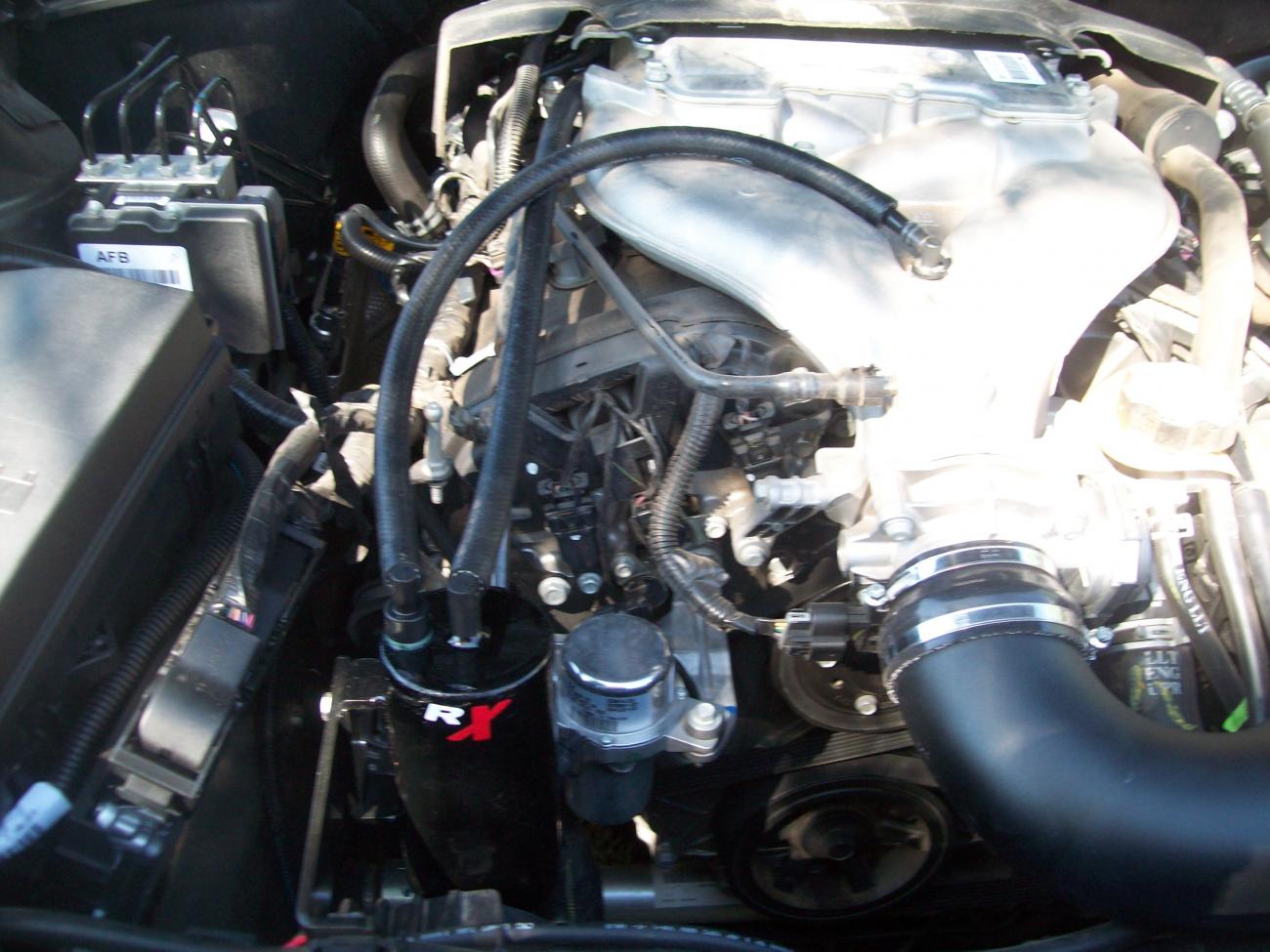

But then I found the cover would not fit on So I used the old piece of tube I cut out and used it for a re-route of the tube and it works better now.

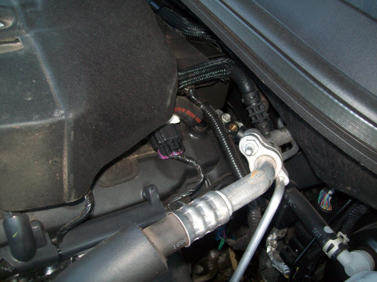

This is the hose I was referring to. Just plug it off on the CAI and the hose itself?

You are right so far. Looks like you have it right. Just plug off the drivers side ones now. Tes, that one the arrow is pointing too, and the one that same hose connects to on the rear of the valve cover, and your done.

HAHA... oh hell. Ok, the tube that connects to the rear PASSENGER side valve cover. That fitting comes off, and the little thing it connects to, needs to be drilled out. Then you reconnect the fitting to it, and attach the tubing, that runs to the catch can( and actually, I just connected my tubing directly to that thing I drilled out) .The DRIVER side tubing and filter thingy, comes off completely and both connections on the DRIVER side are capped off. The connection you have on the top of the valve cover is fine. I would just throw hose clamps on them all.
If you are looking at the pictures on my garage its probably throwing you off, because I mounted the can on the drivers side, and plumbed it behind the engine for a cleaner look.

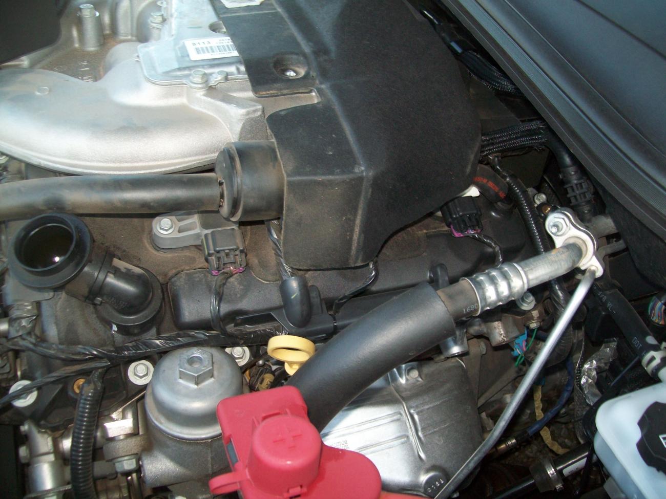

I went out and pulled the PCV valve out on the drivers side with the hose still connected to it and I dont see the silver fitting in there? Maybe mine does not have it? I just went out and snapped a couple of pics back there for you to see.

Read my last one again. It's the passenger side.
