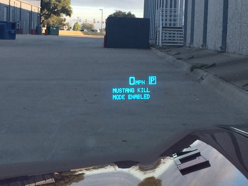

How Many Use The DashLogic on there ZL1?
Originally Posted by revobasher View Post
Just got mine.. 13' ZL1 and flashed with the latest 1.18 firmware (had 1.13 installed).. haven't plugged it into the car yet.. how have you guys modified the profiles, if at all?
I've modified most of the profiles. There are too many profiles and pages than I need. I mainly monitor timing, knock, boost, and temps. Also have one just for instant fuel/throttle %.
You can also do this for fun ;-) it's very easy, just delete the line and add your own text in advance mode. . You can also re-add the lines in their software very easily.

Camero5 is offline   Reply With Quote
