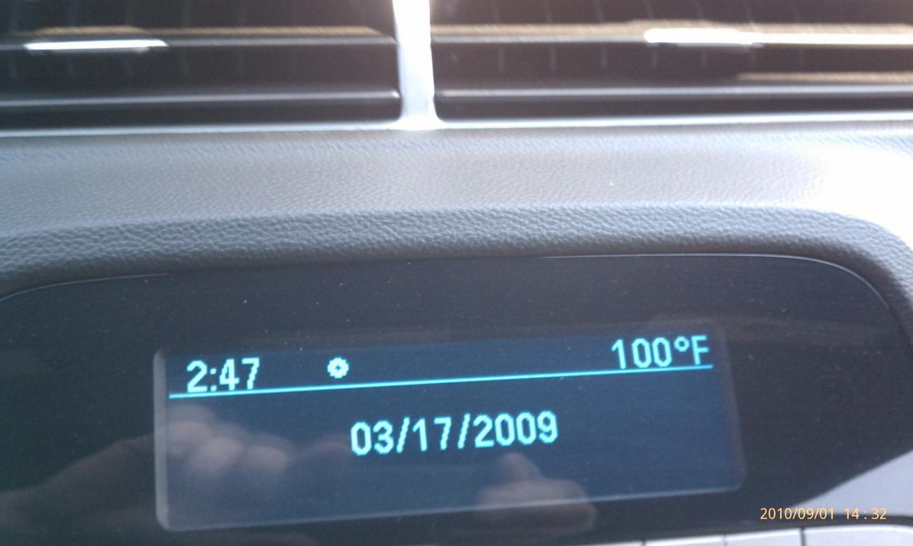

temps
it was also hot as hell today here is a pics i took driving the car after dyno run
so iam sure it hurt the numbers a little because the first runs it was late in the day like 70s or 80s

Originally Posted by tandtperformance View Post
Attachment 159965
it was alos hot as hell today here is a pics iook driving the car after dyno run
