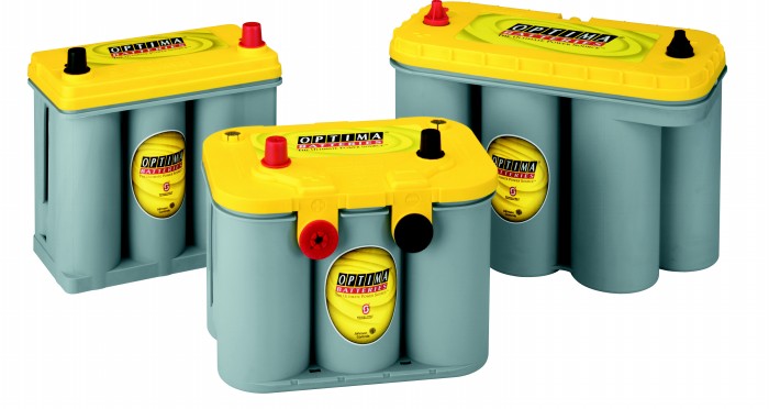

I have used Optima batteries since the mid 90`s in every vehicle I`ve had, factory batteries just don`t seem to have much lasting power, I highly recommend the yellow top Optima.
