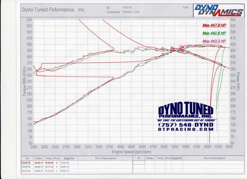

Just got my dyno tune after installing the hotcam. I also have Kooks 1 7/8 headers, high flow cats, and a K&N CAI. The results were 448 HP, 432 Ft Lbs Torque. This cam has good, not great daily driver manners. I love this, totally woke my engine up!
1) what were the before #'s?
2) dyno graph?
3) video please!!!
4) little more on the drivability too.
5) stock valvetrain?
6) dealer install?
7) 219/228 .525/.525 on 112° ?
Thanks
2) dyno graph?
3) video please!!!
6) dealer install?
Thanks
I installed the GMPP Hotcam (219/228 .525/.525 on 112°). I followed the directions and torque specs from this well written post: http://www.camaro5.com/forums/showthread.php?t=125123, I didn't need to drop the oil pan or pull the oil pump, that made it quick and easy. I did this on a budget, but didn't cut any corners on gaskets, and parts (just didn't change springs or push rods, no need to with the hotcam). It's aggressive but sounds AWESOME! Stock I was running 376 RWHP. After a dyno tune (I also have Kooks 1 7/8 headers, high flow cats, and a K&N CAI) the results were 448 RWHP, 432 Ft Lbs Torque. The Dyno Technician figured I was making around 535 HP at the crank. This cam has good, not great daily driver manners.
The technician told me the stray lines are from the "pick up" recieving stray RF from the ignition wire.
redbee03 is offline   Reply With Quote

Thanks redbee,
376 HP stock
+ K&N CAI (12) = 388
+ Catback and Tune (5) = 393
+ Headers/ HF cats (30) = 423
+ Hotcam (25) = 448
So... about 25 HP for the Hotcam ands lots of lope with reduced drivability... Thats about what I figured. I am glad someone finally put this to rest. Only thing that would be better would be to have a dyno run before and after the Hotcam.
