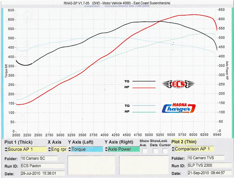

Originally Posted by HufferSS View Post
Why I ask is that everyone with a PD raves about the torque curve but it would be nice to be able to compare, at least to a point, what they both look like in the bottom end.
I was going with a Whipple but the more I think about it....I am leaning towards Centri.
Sorry I missed this post before.. I have a comparison here:
2010 Camaro SS - 6-Speed Manual
ECS Supercharger Kit - 9PSI (Standard boost pulley with restrictor plate for non-methanol)
- Factory Exhaust Manifolds w/ Resonator Delete
- 160* Tstat (Included with ECS Kit)
- NGK TR6 Plugs (Included with ECS Kit)
Magnacharger TVS 2300 - 8PSI (One size lower on boost pulley)
- Factory Exhaust Manifolds w/ SLP LM II
- 160* TStat
- NGK TR6 Plugs
Sales @ ECS is offline   Reply With Quote

Originally Posted by East Coast Supercharging View Post
thanks for sharing your results...
i gotta be honest here... that is one of the ugliest kits on the market!
but HOLY HELL those numbers are impressive!
ill second the question, how do the IAT's compare with the PD blowers?
Well thanks for the comments! LOL.. To each his own I guess. Have you checked out our polished kits?
IAT's run a decent amount cooler than with the PD blowers. Without methanol the PD blowers in our heat/humidity will sky to 180-200* without an issue. I run no methanol with my particular centri kit & I have not seen above 125-135* and that is with ambient in the 99-102* range the last few days!

Cool combo Matt. Have you been able to log the IAT readings with the hood closed going WOT down the track (or highway)? I'm curious to see if the filter placement just above the headers is much of an issue. Open hood not as big a deal, but wondering about real world IATs. Thanks!
Patrick: I went out last night and took a log for you. Of course overnight my laptop died & I did not save the scan file before hand. I'll get you a log after work today.
However, I can give you some results for now at least.. It was 79* yesterday evening. I had the car sitting at idle for 10+ minutes because of a backed up drive thru line at the BK! The IAT's rose while idling into the 96-98* range. At normal cruise I was in the 86-88* range. During a hard 2nd-3rd-4th pull (Shifting ~6500), the highest IAT's I saw were 108*, which came back down to the 88-90* range within seconds of backing off the throttle. When just doing a throttle pull (3500RPM-6500RPM in third gear) I saw the highest 100* & once again came back down almost immediately after letting off
So overall, the IAT's are great considering the temperature and no use of methanol. Coupled with the use of our ECS intercooler, I see no IAT issues at all with this air filter location.
Stay tuned I'll get you the log.
Thanks for doing that. This info is very helpful as other shops running these blowers have been less than forthcoming about the IAT question. I am encouraged by your logs about running this type of blower arrangement. Again, thank you.
