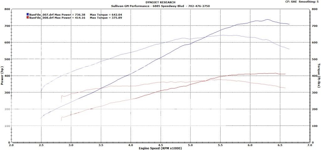

Not a 5th Gen, but I'll post the numbers of my L76 G8 GT.
Before:
414 rwhp/ 375 lbft -tuned on 91 oct
GMPP LS3 heads
NewEra DOD Delete cam 228/240 .590/.598 114 LSA
LS7 cam gear
LS7 lifters
Yella Terra 1.7 rocker arms
Manley chromoly pushrods
ARP head studs
PAC 1218 beehive springs
Kooks 1 7/8 LTH
Corsa Catback
RotoFab CAI
160° thermostat
After:
736 rwhp/ 642 lbft tuned on 91 @ 15 psi (4" pulley)
730 rwhp/ 621 lbft tuned on E85 @ 13 psi (4.5" pulley)
Added: Procharger F-1D w/ Red Race valve
Lunati dual valve springs
Treadstone Intercooler
Aeromotive Camaro Stealth A1000 Fuel Pump
Aeromotive Billet Fuel Pump Controller
FAST Fuel Rails
FAST Fuel Pressure Regulator
FIC 1000cc Injectors
Custom Fuel System
Pontiac G8 GT- ProCharger F-1D, Treadstone TR1235 FMIC, Kooks 1 7/8" LTH,Corsa catback, New Era (228/240) cam, Yella Terra 1.7 Rockers, GMPP LS3 CNC heads, Aeromotive A1000, FAST fuel rails, FIC 1000cc injectors - 762 RWHP/646 LBFT tuned @ 11psi on E85 using HP Tuners
Camaro ZL1- Stainless Works 2" LTH, Corsa catback, RSC PDx cam, ID 1050x injectors, DSX fuel kit, New Era 4.5" intake, BTR springs/pushrods, AFCO heat exchanger, New Era expansion tank, Innovators West balancer, Metco 9.55" lower - 609 RWHP/591 LBFT tuned @ 8psi on 91 octane using HP Tuners
