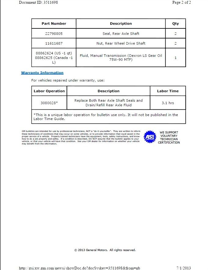

Posts: 1,198
Originally Posted by Rangore View Post
Wow! Great info. Thanks. Do I tell the dealer there is a TSB on it or does this go under my extended warranty?
I'm not sure about warranties I was under my 3/36 still when I went in. Its not that bad of a job if it isn't covered and there's even a YouTube video on it.

Originally Posted by Pluto View Post
I don't know if the TSB applies to your year model, but your description sounds a lot like what my car had. They had to replace the axle seals and fluid per a TSB and the noise went away. It would only happen backing out of parking spaces and doing slow turns through a parking lot. I took it to the dealer and drove a few donuts at 3-5 mph to enhance the sound.
So you are saying there is a TSB that applies to your 2013 SS? I'm asking because I have the same model year. My car is about to go off of the 3/36 warranty so was thinking if there was a known TSB I would have it checked prior to that.

I think we are are talking about two different things here.
This noise is definitely coming from the right front just like the OP's car.
The TSB also states people may complain of growling from the front end...it may or may not be that I've just heard a lot about it. The differentials don't seem so strong in these cars.

TSB
The TSB had multiple revisions and I believe covered multiple years. The latest number is PI-0137D
I can live with some minimal power steering moaning sounds. Its a Chevy, not a Mercedes. Not a problem for me.
For anybody who is interested in the TSB for the "groaning" that may be coming from the posi rear end, here it is:
from: http://www.revbase.com/BBBMotor/TSb/...dPdf?id=180216
