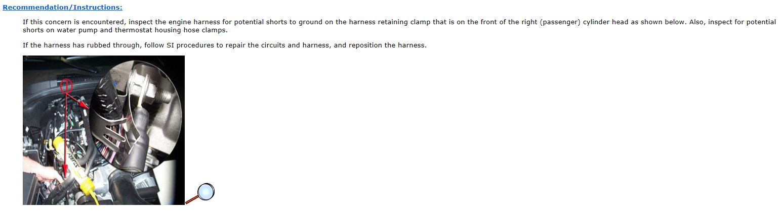

Harness is probably shorted
Harness is probably shorted there is a TSB out for it. I have attached the verbiage from the bulletin.

Originally Posted by ATCK45 View Post
Attachment 891750
I was having issues with the car not starting intermittently and error codes for the cam and crank position sensors. Turned out be some shorted wires in that exact location. There are a lot of wires there. Any one of them could cause a bunch of issues if they're cut or shorted.

Before swapping parts back and forth, I'd check that wiring harness bundle for damage on the passenger side of the engine. Fuel injector wiring runs through that area. Poor decision on GM's part concerning the routing of that harness and the way its secured. They used harness clamps that act like razor blades with the constant vibration of the engine. Then one harness is a fraction of an inch above the most intense heat source on the car. Once the razor clamp cuts into the protective wire loom, the harness slides down onto the exhaust manifold.
The wiring for two sensors were cut into on my car. The error codes and symptoms pointed to bad sensors which I almost purchased.

Originally Posted by LCPLPunk View Post
I looked at it yesterday and didn't see any glaring damage, but I'll look again today.
Mine wasn't either, just looked loose. Once I freed the harness and removed the harness clamps, thats when I found the shorted wires.
