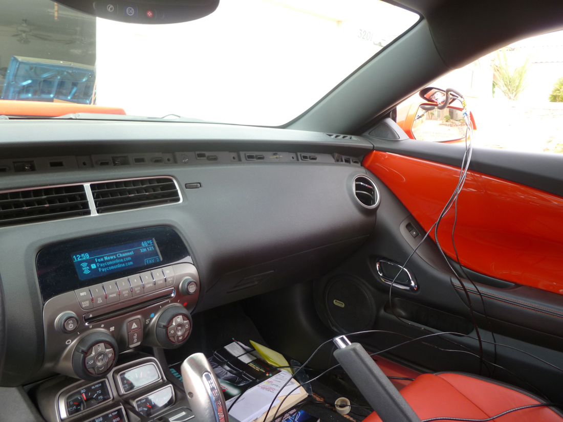

I removed the XM antenna, But its to cold to move the wires today, I will move them in the next day, car look like it was meant to be, Why did GM not do this to the car.

No problem i started moving the wires from the roof man that is some work it will be better for the convertible cars, Any way here is some pics, Had to cut some tape and reroute the 3 coax wires i am to mid point of the front seat, But the way i connected the XM antenna and put it on the outside mirror and it work fine in my garage with the door closed.(garage door closed)

Thanks for the pictures. I was hoping the wires were routed by way of the windshield pillar which would have made it easier, but no...
