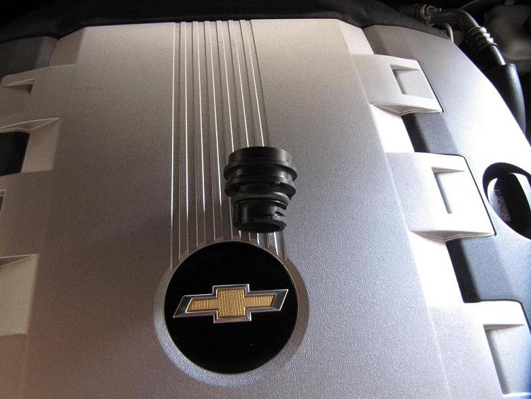

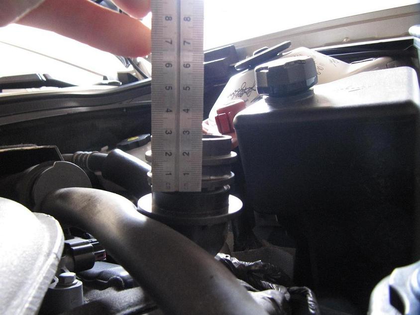

Originally Posted by Macrackie View Post
Question... Why will the stock engine cover not fit? Does it hit the hood or is it that the mounts are not tall enough? If the mounts are to short i can make new ones.
Originally Posted by hapisok View Post
raising the manifold doesn't allow for the engine cover to reuse the mounting post for the engine cover as well as the oil fill tube. not sure how tight the fit would be if all those points could be adjusted, im sure it would fit but probaby make contact with the hood liner too.
I've been watching this thread, and this may be my next mod. I would also like to install my engine cover if possible.
Has anyone tried to lay the engine cover on top of the intake with the 25mm spacer installed? If the cover is clear of the hood insulation, I may have found a solution to the oil filler tube height.
This spacer is an oil filler tube from a G8 with a 3.6, it measures 25mm.
Name:  mace adapter 006.JPG
It fits right into our LLT oil filler, and just screw your existing oil cap or breather on.
Name:  mace adapter 005.JPG
R6P is offline   Reply With Quote
Attachment 331591
Attachment 331594
I think you've got the solution!
I got my eng.cover out of mothballs and checked- in the back, the cover is that form fitting black felt (thin) cardboard stuff. You'd have to cut the back 1/4 of this off now that the IM is raised- the part of the cover that you normally can't see, but if you do a good job no one would even notice.
Its held in place by 2 trim retaining pins (the push/pull kind) on the top of the IM. The back of the primary eng.cover has 2 hooks that slide under the black felt, and then attaches to the pin and under the oil fill cap in front.
Now the front will likely sit up a bit higher when attached as planned, but I just laid my cover on top of the raised IM and closed the hood without difficulty.
