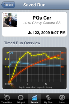

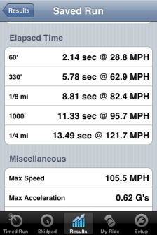

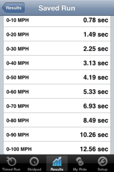

Originally Posted by solo40oz View Post
hey irpq11 -
I haven't read thru this entire long thread...and maybe you've already figured this out......but I noticed something on your dynolicious graph that you posted on another thread...notice in the 1st run that the 0-60 time is 7sec...but also notice that acceleration doesn't start until 1 second...which means this was really a 6sec run
On the 2nd run though...look at the flat acceleration at time 0...then the spike at like 6sec....that doesn't seem right
Ya, I noticed both of those. It leads me to believe that the Dynolicious app isn't real acurate or it just gets confused. Here is an example. My latest run. I did the whole quarter mile. The info looks good except for the final speed. I think the top speed is acurate but reads below the 'final speed'
Obviously I wasn't doing 121 mph but I WAS doing 105 mph by looking at the gauge when the beeper went off telling me that it was 1/4 mile.

Originally Posted by rpepka View Post
Where you at with the dealer Randy?
They still aren't ready for me.
