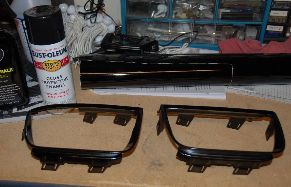

Originally Posted by Michael_Js View Post
Yes, there are 3 button top pins over the plastic covers in the trunk - over the lights. No need to remove the lights. Also, not the covers behind the lights that you unscrew. This are directly under the trunk lid. Remove these - small screwdriver to lift the heads, then you can slip your hand in & gently push the tabs while you pull the bezel out. # 5 in the picture above - that picture doesn't show the covers...
The bezels are all different depending on their location - Right outside, right inside, left outside, left inside. So the tabs are in different locations - except the bottoms look about the same.
Attachment 94473
Attachment 94474
Are you painting black to put back on the car
Attachment 94473
Attachment 94474
Yeah, I've totally done that. Now I just can't get the bezels loose. Those bottom ones are a bitch to get to.

Phew.............. I FINALLY did it!
It was hard, but my wife and I pulled it off!
Small hands are handy after all.
Basically you have to press down on the tab while pushing, while tugging on the chrome your pushing, from the outside. once you do that for all of the tabs it becomes easier, I also noticed that the sides are the most important. I think I've read that on somewhere here on the forums.
I did this without removing any bumper any tail lamp or any bolt. I found out it was unnecessary. only bolts you might need to remove are the outer edge tail lights. But other than that, if anyone else but me is having problems with this, get a wife with small hands lol. Or keep trying and go for the sides/bottom tabs.

Took mine off. It hurts to remove them. Be carefull. One of the tabs on mine did break as well. One tip is to remove the tail light bulb and socket and push it out of the way. It gives you more room to work.
But damn it is not easy. Use lots of patience.

Removing them
Heres what you have to do. Get a flathead skrewdriver and put it between the bottom part of the bezel and the light and push it out and they will pop out. Thats how I did no other way would work for me
