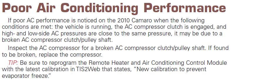

Originally Posted by heinzd01 View Post
Below is all I noted in GM TechLink
Attachment 118133
Attachment 118134
Attachment 118135
So this is what was wrong....
They had to replace two compressors on mine.... they did something else as well the second time and it has been fine since but wait here comes the summer stay tuned.....
