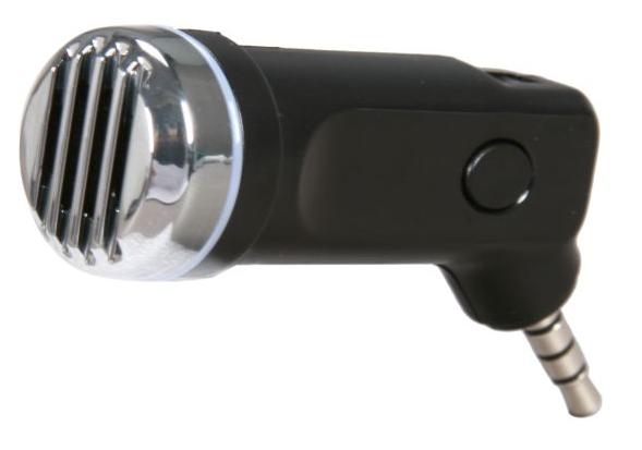

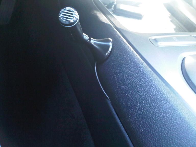

DO NOT BUY THIS. IT IS VERY CHEAP AND MY BATTERY'S LIFE WAS SHOT AFTER TWO WEEKS.
Originally Posted by Iwantone2 View Post
Actually, the cheapest and ghettoest (<-- sp?) way to get BT is by using the following:
Attachment 180410
http://www.newegg.com/Product/Produc...-623-_-Product
You just plug it into the AUX port and you can hear the phone conversation through the car speakers. It comes with a handy AUX extension. I routed it this way so that the cable wouldn't be exposed:
Attachment 180411
Some of the downsides however, is that the battery doesn't last as long as advertised. For some reason if you are running the A/C while you are talking, there's a lot of static.
Other than that, the call quality is good!
