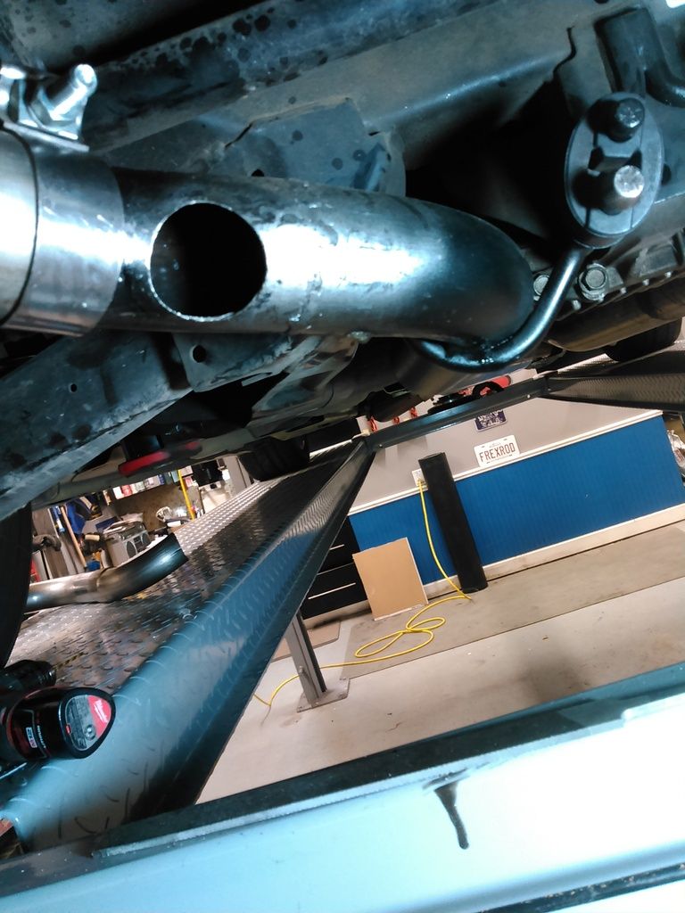

Supercharged.. LT HEADERS ETC,
Put mine on from solo this weekend ...unbelievable ...work perfect
Are those hanging down lower than the diffuser? Sloppy work. Mine run alongside the muffler and are tucked up inside of the diffuser.
1LEJNG is offline   Reply With Quote
Old 04-19-2017, 09:46 PM   #487
ZOOK
ZOOK's Avatar
Drives: 2010 2ss 6 speed
Location: NEW BRUNSWICK CANADA
Posts: 328
They are out of site ...pic is from under car on hoist
