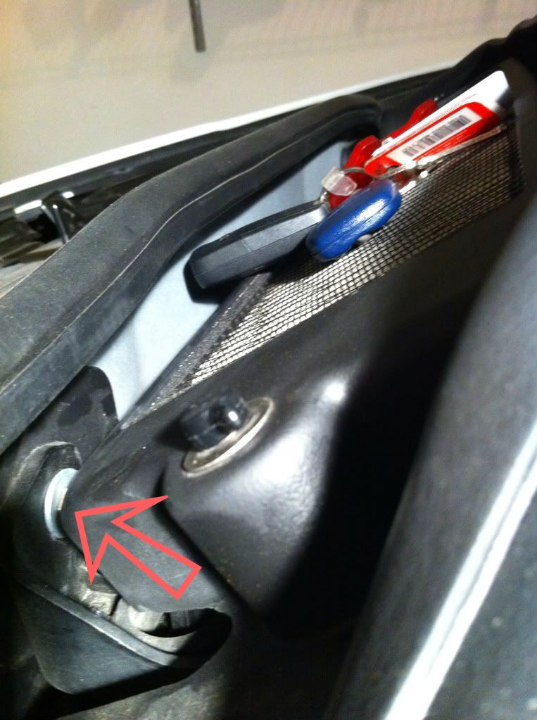

I see. The reason I asked is that it doesn't look tilted here. Unless I'm wrong

It is tilted according to VR's instructions.
