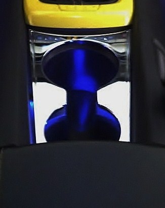

Pop off the four gauge pack. The yellow wire is going to the gauges. It is the power wire for the ambient lighting.

Yep
Originally Posted by recontango View Post
So if you tap into the yellow and black wires in the TC switch it will come on and off with the lights? And can be dimmed?
Very Cool.
I used those wires and it looks great. It comes on and dims with the ABL in the doors and the dash. Plus those are very easy to get to.

Just finished mine the same way. Just an FYI, for anyone using those lights from pepboys (the led spots on the first page) when you cut off the adapter to get at the wires, there is a "hot" and ground wire in each strand. Meaning, there is a blue and ground going to one led, and a red and ground going to the other. Twist the blue and red together and tap that into the yellow wire off the TC switch. The two grounds get twisted together and go to the black wire off the TC button. The wires are tiny so I twisted them together a few times to ensure the t tap made a good connection. Super quick mod.

I have a couple of questions
where can i find this cup holder cover? I checked hi tech customs store and couldn't find anything
and
How do the oznium leds come? Are they already in a line together or a they each separate? If they are separate how would I connect them ?

I am about to do this too. I want to get the Oznium lights but I don’t know which to get. I see there are several options such as one on each side or a strip on each side. Which would work best to light it up the most? I may wait to do this until I can afford to buy a gauge cluster pack so that way I have the dimmable wire to affix to.

[QUOTE=BrandonB956;5253136]I have a couple of questions
and
I got mine on eBay and the Led's from 'Oznium'...
Well i ordered rectangle LEDs (2mm x 5mm x 7mm ) to light it up. Will use resistors to lower voltage if i have to.
Did you use the same LEDs for the cup holder and the foot well lighting? Thanks!
I was going to wire off of the gauges (yellow wire) so they could dim or at least turn on/off with them.
