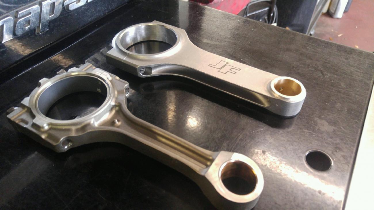

Here's a couple more pics of the forged rods side by side with the factory powdered metal LFX rods. They look a little stronger to me...
