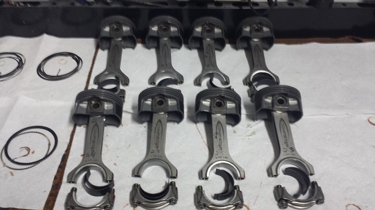

Engine Assembly
pictures of the assembly

Holy crap! is this rear wheel or engine hp, either way the car is going to be a hoot to drive!! By the way enjoyed your "novel", it's what being a true car lover is all about!
Did you build this stroker or is this at the shop?

I had the motor built, then we put it in the car.
