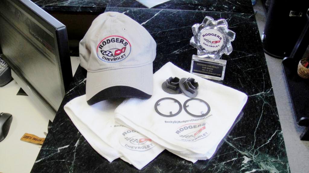

Maureen at Rogers Chevy hooked me up big time.
Gots me some some goodies too.

Problem FIXED.
Easy DIY here.
Sweet... Check this out...

Wow! I cant believe those washers solved such a nasty sounding issue. Ill have to hit Maureen up for the parts tomorrow. I think I may still have a CV issue on the right side though. Seems to be a lot more play than in the left. Thanks for documenting the fix PQ. Great job.

Thank you for making this thread. My 2013 started making this noise over a year ago and it progressively got worse to the point anytime I would stop and go it was emitting the sound/noise. I ordered a new axle nut and washer with the item #'s you provided and problem solved. Thank you again for the videos and information.
