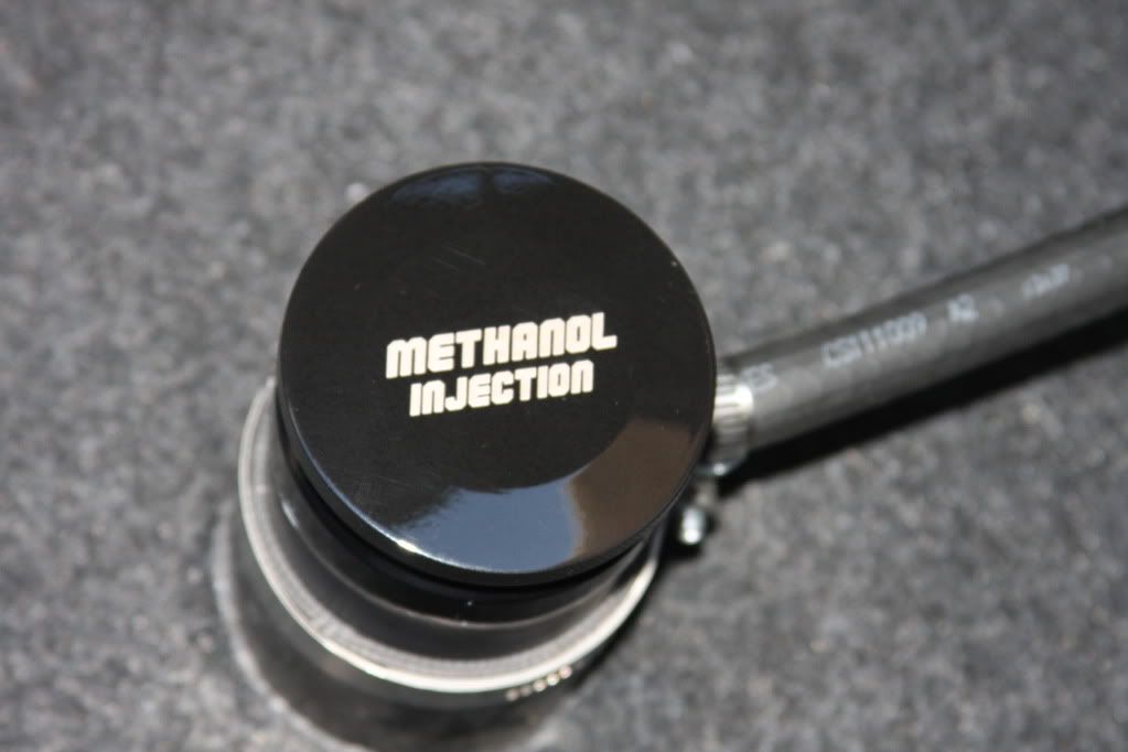

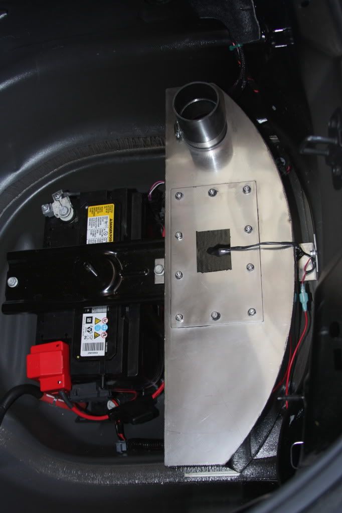

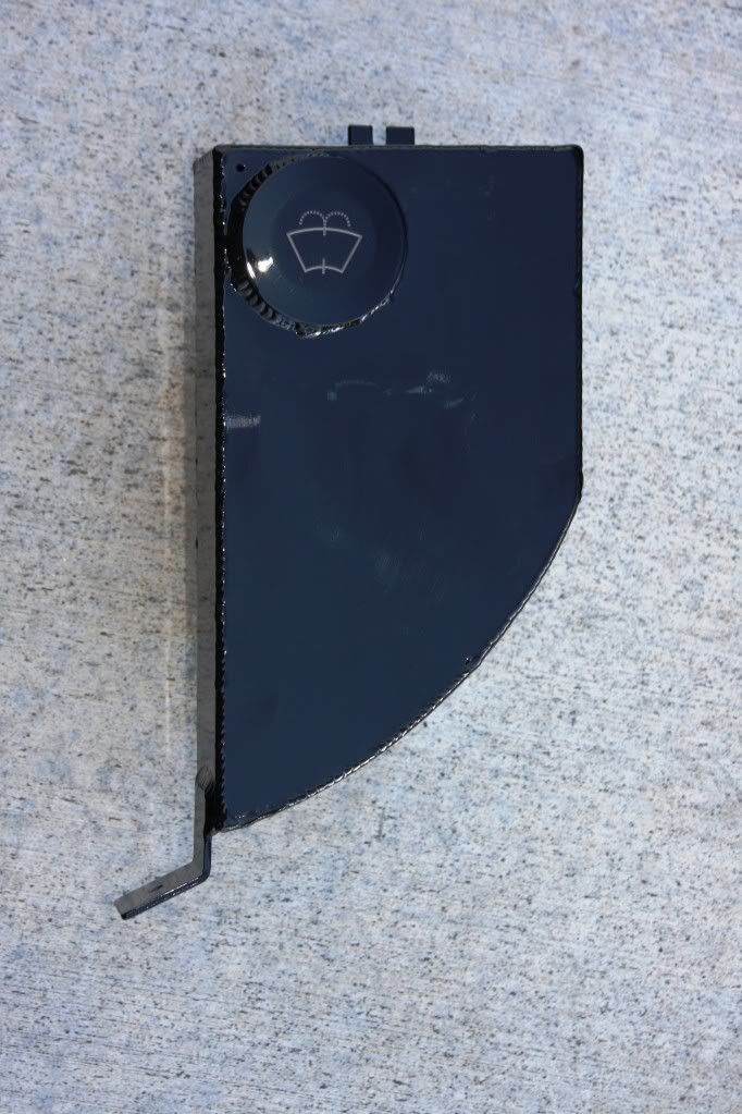

Here is an example of a stainless Methanol tank we offer for the camaro customers that come to us. We do this all in house.
The tank is hidden down where the tire pump was.
We also offer this windshield washer tank that some use as the tank up front
These are also options we sell with our Twin turbo kit
